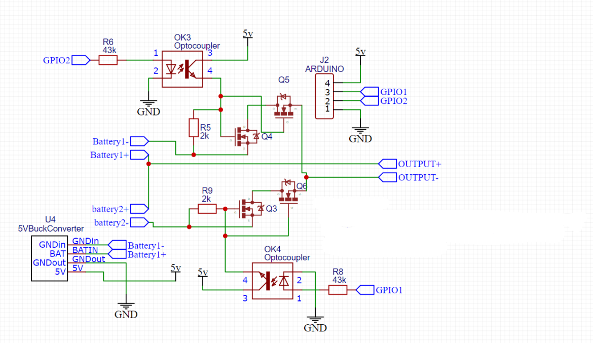

schematic which was used. ignore 5v going into the optocoupler that is now 12v. which is from same buck converter nothing else was added.

Thank you for the new schematic. I have not studied every detail but can immediately see problems.
First a minor thing as you did point it out:
Please don't do that, please post a schematic that is, as best as possible, correct, not one with known errors.
Now to the more serious problems that I can see (there might be others). You clearly don't understand that voltage is measured between 2 points, and one of those points is, by convention, 0V or ground unless specified otherwise. Add to that components only see the voltage of the things that they are connected to, they don't know or care about other voltages in other parts of the circuit that they are not connected to. Now to explain how that relates to your circuit.
Both battery +ve are connected together, and you switch battery negative. This is NOT 0V or ground, it is battery negative. To be 0V the battery negatives would have to be connected to 0V permanently, and they are not. Connecting the positives together added to the purpose of the circuit means they are not and cannot be 0V. Q4 and Q5 are supplied with gate voltage from OK3, which is connected to +5V (or +12V), which is referenced to GND (0V). The problem with that is the MOSFET needs a voltage on its gate with respect to its source, so if you are applying +12V to its gate, and the 12V is referenced to 0V, but the MOSFET source is not connected to 0V but to some other voltage then there is not the expected 12V gate - source voltage, but some other voltage that depends on, amongst other things, the state of charge of the battery.
The same problem applies to Q3 and Q6.
You are trying to have the battery circuits separate while at the same time treating them as connected. You can't have it both ways.
So, you are thinking "OK, what do you suggest?". Fair question. At the moment I don't know the answer because I've not done what you are trying to do and not worked through the problem.
To solve this you have to ask yourself where the current is going to flow to get back to where it came from, and pay attention to what voltage is what and what it is measured in respect to.

I don't understand the dual N channel MOSFET thing with the MOSFETs in series like that, connected drain to drain, I can't see what that is means to achieve, or how it can work. It doesn't help that the schematic does not follow the convention of lowest voltage at the bottom, highest at the top, which makes it difficult for me to follow.

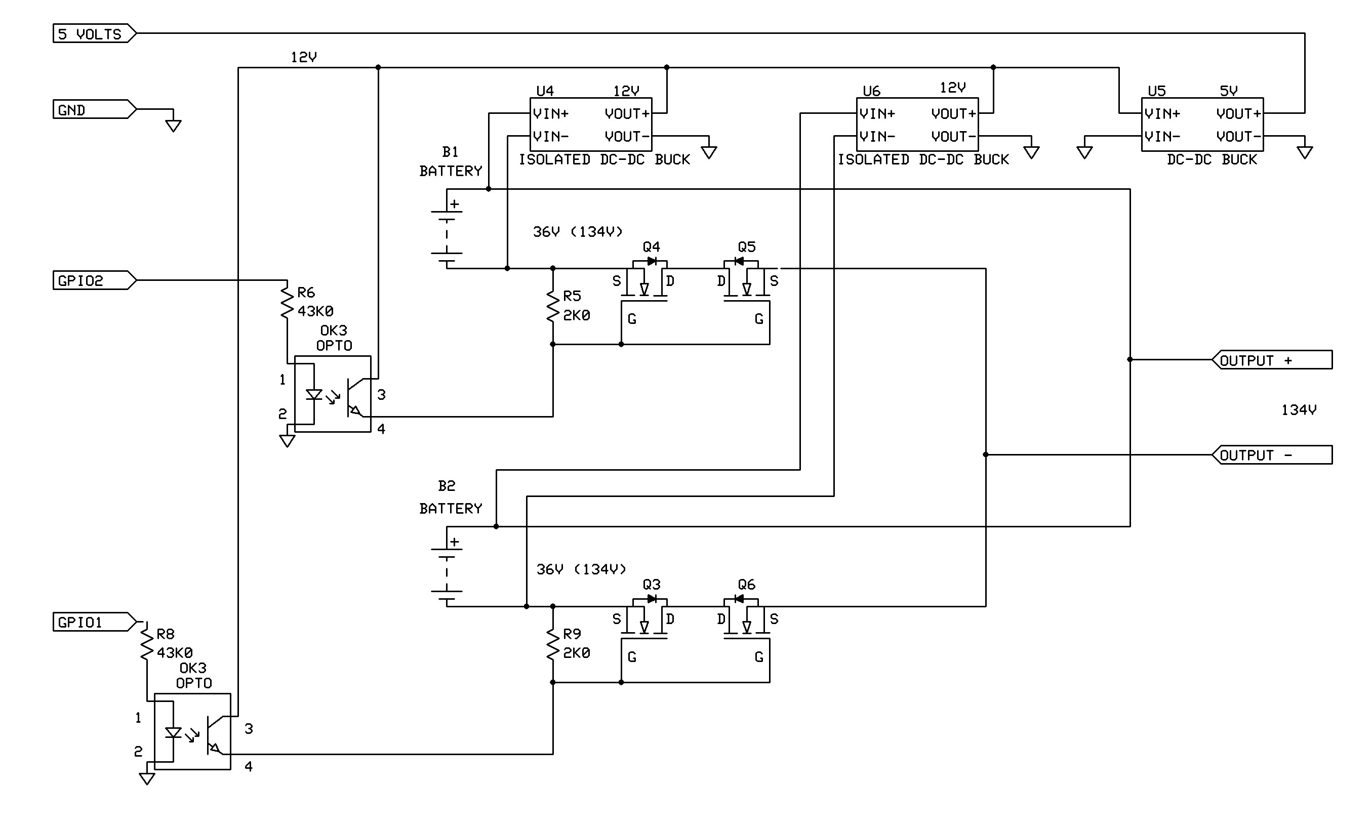

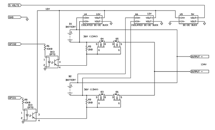

I hope I have interpreted your schematic accurately.
Your problem is you need to switch each gate on with positive gate voltage WITH RESPECT TO EACH MOSFETS SOURCE.
You use a 12V supply that is referenced to a gnd that has no part in either battery circuit, which I would regard as a floating battery circuit because it is not reference to control gnd.
Are you using your DMM to help trouble shoot?
Measure the gate - source voltage on Q4 and Q5 when you select a Battery1, AND then measure the gate- source voltage on Q3 and Q6, which both should be zero volts for your circuit to work.
You basically have your isolated converters in the wrong place, I believe.

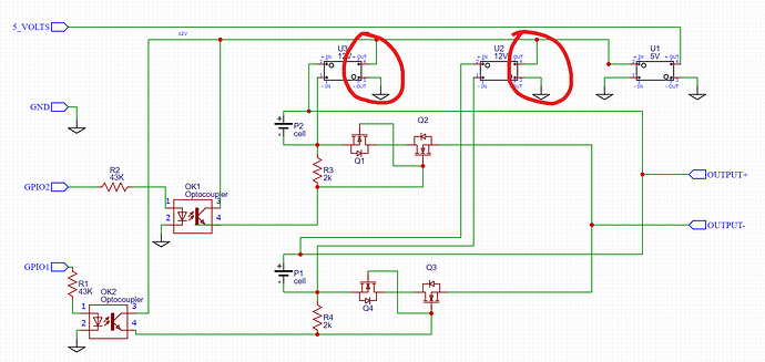

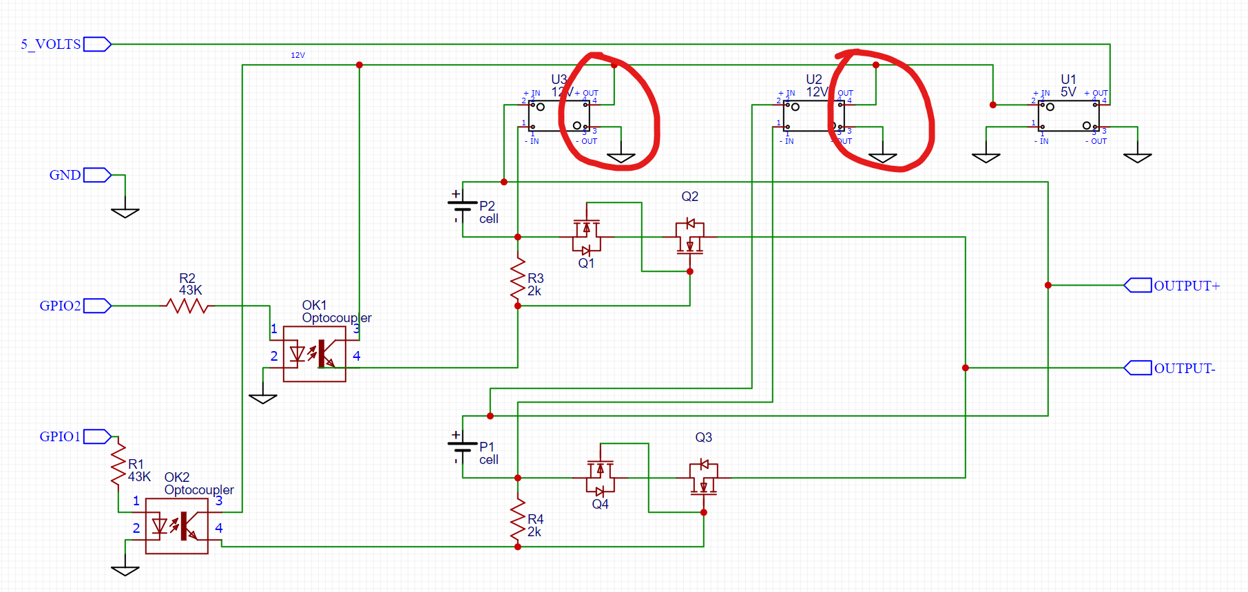

i found there's a problem in the circuit which i have circled (Also i have copied your design in my software so i can modify it.)
In your schematic, you're using isolated buck converters for converting the battery voltage. however I don't have those, mine say they are isolated but they weren't! they still have a current path. so connecting both grounds to common isn't possible due to different voltage potentials in the circuit introduced by the batteries. I've fixed that to how i have made this circuit in real life here:

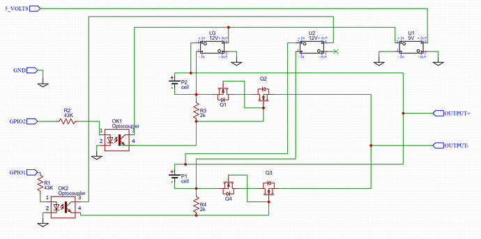

please have a look at my updated schematic to see if that would be in the correct place.

EDIT: I have created the circuit in real life, and connected batteries which have a voltage difference of 2v and they seem to be switching properly. and nothing is getting hot. However, as soon as i connect batteries which have voltage differences of 16v Q4 and Q3 start to get very hot and soon destroy themselves. I believe this is the 2 batteries trying to equalize and the mosfets blowing up. but why? The gate voltage of OFF mosfets is around 200mv.
(Both of the mosfets are NOT on at any given time they are always switched one after the other.)
(I understand the risks involved in this and all of this is done in a controlled environment.)
