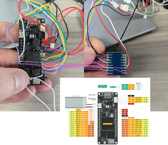

It's an SX1262 HF module. I'll post a schematic of the connections in my next reply. Basically got the connections as follows:
NSS connected to CS (D7)
MOSI connected to COPI (D8)
CLK connected to CK (D9)
MISO connected to CIPO (D10)
3v3 connected to 3v3
Gnd connected to Gnd
RST connected to D5
D1O0 connected to D5

I don't know if that LoRa library supports the SX1262. I was going to try the RadioLib library but at first glance, looked a bit more advanced/involved
The LoRa library you are using is probably the one that is for SX127X LoRa devices only.
A SX1262 does not have a DIO0 pin.
A SX1262 has a BUSY pin which needs to be connected.
The RadioLib library does support SX126X or try this one;
In addition to the errors mentioned above, assigning two different functions to the same pin is usually a bad idea.
Here is a photo of the wiring. Not sure if I am making it more confusing by adding the pink arrows.
Apologies on the reset and D1O1 pins, I was looking at the PWM numbering. These two connections are in fact on D0 and D1.
So from your reply @srnet , I should change the D1O1 wire onto the BUSY pin?
Any other errors you can see from the wiring? I was meant to check the continuity of each with a multimeter, but I haven't got around to it... just to rule out its not a dodgy connection from my rather poor soldering skills.
I'll see if I can try the SX12XX-LoRa library once I have confirmation on the wiring.
also check for short circuits between adjacent pins and make sure you connect an antenna

For an SX126X you need to connect DIO1 and BUSY to separate GPIO pins.
Your SX126X module also has TXEN (TXENABLE) and RXEN (RXENABLE) pins, not all S126X modules have these pins. You need to check the datasheet for your module to see if they need to be connected.
