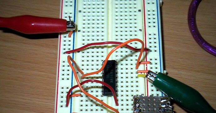

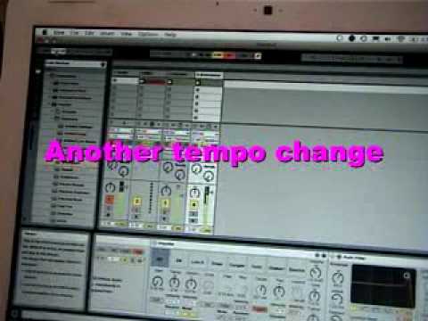

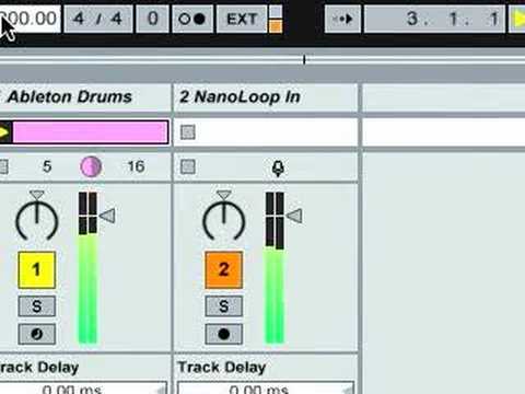

Well the very first model of Gameboy was the DMG (Dot Matrix Gameboy) I've seen these synced with other DMGs and computer programs as well. I know you can sync a Gameboy color running nanoloop 1.5 to Live. (I'm pretty sure a gameboy color has the same I/O as the DMG) check out the last two videos on this reply. Every version of nanoloop is designed to synchronize with another copy of the same version. So there's a way you can get two gameboys to give each other info. Why not send those signals into an interface then, via MIDI, signal Live? The Gameboy Micro's battery charger input is also an I/O for multiplayer and other functions. Check this page out I just found, http://www.amazon.com/Nintendo-Game-Boy-Micro-miniSync/dp/B000H15MJG. It says here that with this chord you can sync your GBM with your computer. I have no idea if ableton live could see a GBM through this cable or not. As for what I want to use to control "tempo, start, and stop" with, just the devices themselves. Their built-in start, stop, and tempo controls. Ideally each device could control the universal tempo but it would work if I could just control tempo with Live and the Gameboys would respond to the tempo changes. Now that I think of it, starting and stopping the Gameboys with Ableton would be nice but I don't know if that's possible. Another thing I should clear up is I don't need to trigger Ableton Live with the Gameboys (Unless it's possible to control the universal tempo with the GBs), just the Gameboys with Ableton Live. I guess what I'm asking for is help building a MIDI clock or MIDI merger to these specifications. So Ableton Live could control the tempos of the Gameboys and keep them in perfect time with Live.

http://little-scale.blogspot.com/2009/02/1-nanoloop-midi-sync.html
or this : http://little-scale.blogspot.com/2008/05/nanosync.html (from the creator of the second video )..
EDIT: I didn't saw that you have put a message on the blog already, i didin't exaclt understand your prob, did you try to build this nanosync device ?? or it is incompatible with the nanoloop 2.5 ?
