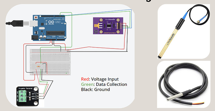

Hello everyone,
I currently have the setup shown below using an Arduino Uno, Atlas Scientific ORP probe, DS18B20 temperature probe, and an Atlas Scientific isolated carrier board. With the current code below, we are able to see readings from both probes in the serial monitor (although for every five temperature readings we receive one ORP reading). However, the ORP readings stop outputting to the monitor after 13 times while the temperature continues to output. Our main objective is to have both probes constantly outputting to the serial monitor without need for two separate codes. Tinkering with the Serial.readstringuntil() command doesn't appear to have an effect. Thanks!

I don't know what an ORP is but, for the DS18B20, your loop timing is totally unreasonable and probably nonsensical too. The DS18B20 requires, in your setup, 750ms to do its job. If you change the delay command to from 100 to 1000, you might get a result.
In the unlikely event that you really need temperature readings at 1/10 sec intervals, you need a different sensor.
Particularly since the thermal time constant of the probe is in the 10s of seconds or even minutes range.
This waits AFAIK for the conversion, up to 750ms.
Leo..

Please include ALL hardware, component names and pin labels.
The Fritzy image you have posted really doesn't show us much.
Thanks.. Tom... :+1: :coffee: :australia:
The software serial Rx.Tx and one wire connections in your diagram are wrong, probably because you counted 1,2,3, instead of 0,1,2,3... but, other than that, it is fine, and you have obviously gone to some trouble with it.
Further, since you actually receive some results, it is pretty clear that your wiring is kosher anyway, and your errors irrelevant. I guess you would have done the same thing if you did it by hand.
I now understand that the ORP has something to do with water turbidity. Be aware that the DS18B20 isn't as waterproof as it might look.
