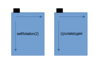

@david_2018 and @theboot have already posted what the most likely reason for your issue is: It is the rotation of your screen.
I checked with my ILI9341 LCD Touchdisplay
The picture shows the increasing values of touch coordinates. They always start on the top/left edge of the screen (the black part is the external power jack of the UNO). If I set rotation to 0 or 2 text is displayed as the text here.
The touchscreen does not know anything about the rotation of the display, it is handled as a separate device.
That's quite likely also the case with your device. You can try to change rotation
  • from 1 to 3 or
  • from 0 to 2
Good luck!

So that did work but now for the other buttons, there is the same problem. The button on the far right is now read from the bottom left. but now the first button works
Have you tried it on your display, if it works for you it might be my display.

If orientation of the touchscreen is a problem, that can be handled in the two map() functions.
In the following code, I am swapping the x and y coordinates to match the display rotation. It might also be necessary to reverse the direction of the X or Y axis by reversing the last two arguments of the map().
I think it is a bit easier to read if there is a function for checking the button presses, that way you can use the same format as the fillrect() function for defining the bounds of the button.

Would you be able to explain why you switched the x and y values, I'd like to fully understand the code and make comments as well for anyone else in the future who needs it.
  int y = map(p.x, TS_MINX, TS_MAXX, 0, 240);
    int x = map(p.y, TS_MINY, TS_MAXY, 0, 320);
The touchscreen and the display are separate hardware. Rotating the display does not rotate the touchscreen, and the touchscreen library has a fixed orientation for the x and y axis of the touchscreen. The reason I swapped the x and y coordinates returned from the touchscreen library was to align the touchscreen with the x and y axis of the display.
So you can get an idea how it works
A touchscreen is 2 pieces of resistive material with a small gap between them mounted on top of your screen. When you put pressure on the screen that causes the 2 pieces to contact each ither
When you touch the screen the touch screen controller will read the resistance values along both axis. Touching different parts of the screen will give different resistance values on both axis.
These resistance values are what you are mapping to coordinates on your screen. Apart from having the logic chip for this on the display pcb, they share nothing in common
Rotating the display means you need to map these resistance values differently, as the same corner of the screen is always going to read similar resistance values
Every resisitve touch panel will give slightly different resistance, which is why you need to calibrate them.
Resistive touch screens are not very accurate, but they are good for when the screen will get moisture on it.
If you need very accurate touching (with reading multiple touches at once) you can get capacitive touch. These are what mobile phones use.

  tft.setRotation(3);  //changing this value between 1 and 0 will change the layout of the text on screen. landscape portarait
