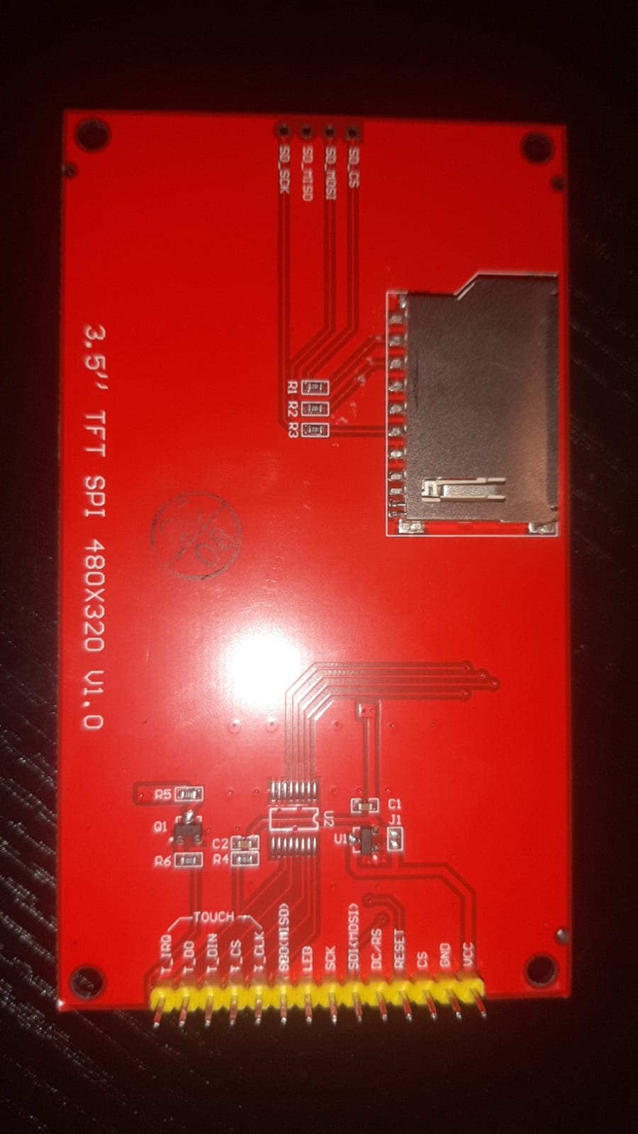

I am using the tft espi library to control a ILI9488 TFT LCD with esp32. I was wondering if anyone could help me. The wiring and code is correct as i followed the official documents. But it still only shows a white screen. This is where i bought the screen from: https://www.amazon.ae/Screen-Module-Display-Replacement-Repairing/dp/B095CW4RTT/ref=sr_1_1?crid=2UWFAPLADD5SX&keywords=tft+lcd+module&qid=1695125416&sprefix=%2Caps%2C197&sr=8-1
The esp32 works with other projects too. (I am not trying to get touch to work):
The Lcd Pictures:
Please Help
Thank You
Izyaan.

Does that display require 5V or 3V power supply? Some of them use 3V for I/O but need a 5V power supply
I don't think so....

Hello,
Both the I/O pins as well as the VCC require 3.3V
Please help
5V U1 is the voltage regulator. For 3V3 J1 must be closed.
hello, I don't understand as i am just a beginner could you tell in simpler terms
Please help
The TFT board is selected for 5V VCC. On the backside you have a component with text U1. That component brings the 5V to 3V3. If you use 3V3 VCC you must shorten J1 with a little bit solder.

#define USER_SETUP_ID 21
#define ILI9488_DRIVER
//#define TFT_INVERSION_OFF
#define TFT_MISO 19 // (leave TFT SDO disconnected if other SPI devices share MISO)
#define TFT_MOSI 23
#define TFT_SCLK 18
#define TFT_CS   15  // Chip select control pin
#define TFT_DC    2  // Data Command control pin
#define TFT_RST   4  // Reset pin (could connect to RST pin)
#define LOAD_GLCD   // Font 1. Original Adafruit 8 pixel font needs ~1820 bytes in FLASH
#define LOAD_FONT2  // Font 2. Small 16 pixel high font, needs ~3534 bytes in FLASH, 96 characters
#define LOAD_FONT4  // Font 4. Medium 26 pixel high font, needs ~5848 bytes in FLASH, 96 characters
#define LOAD_FONT6  // Font 6. Large 48 pixel font, needs ~2666 bytes in FLASH, only characters 1234567890:-.apm
#define LOAD_FONT7  // Font 7. 7 segment 48 pixel font, needs ~2438 bytes in FLASH, only characters 1234567890:.
#define LOAD_FONT8  // Font 8. Large 75 pixel font needs ~3256 bytes in FLASH, only characters 1234567890:-.
#define LOAD_GFXFF  // FreeFonts. Include access to the 48 Adafruit_GFX free fonts FF1 to FF48 and custom fonts
#define SMOOTH_FONT
// #define SPI_FREQUENCY  20000000
#define SPI_FREQUENCY  27000000
// #define SPI_FREQUENCY  40000000
// #define SPI_FREQUENCY  80000000
// Optional reduced SPI frequency for reading TFT
#define SPI_READ_FREQUENCY  16000000
#define SPI_TOUCH_FREQUENCY  2500000
Please help.
In the second file must be comment //#include <User_Setup.h>
In Setup21.... all the not needed fonts in comment. Needs only space.

I have tried it.. the code runs sucessfully with no errors but the lcd still doesn't display anything
Is there a possibility that the lcd is a fake one.... heres the link: https://www.amazon.ae/Screen-Module-Display-Replacement-Repairing/dp/B095CW4RTT/ref=sr_1_1?keywords=TFT+LCD+DISPLAY&qid=1695223607&sr=8-1
I think not so. What is the used code? Try one of the TFT_eSPI examples in the 480x320 directory.
I have tried it , it stilld oesnt work
