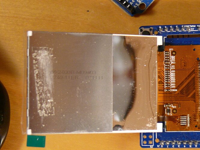

On the back site of display can I find...
"VVX2400B-M09#03
0240-11ER 071111"

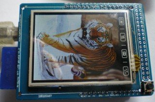

I can see printing in this photo but I can not read it:
And this image says nothing about the shield. It is just the Arduino headers.
I need to know what is printed on the shield.

The front view is just a blank screen. However you can see that it has a Touch Panel. And which way is "up". e.g. the house icon.

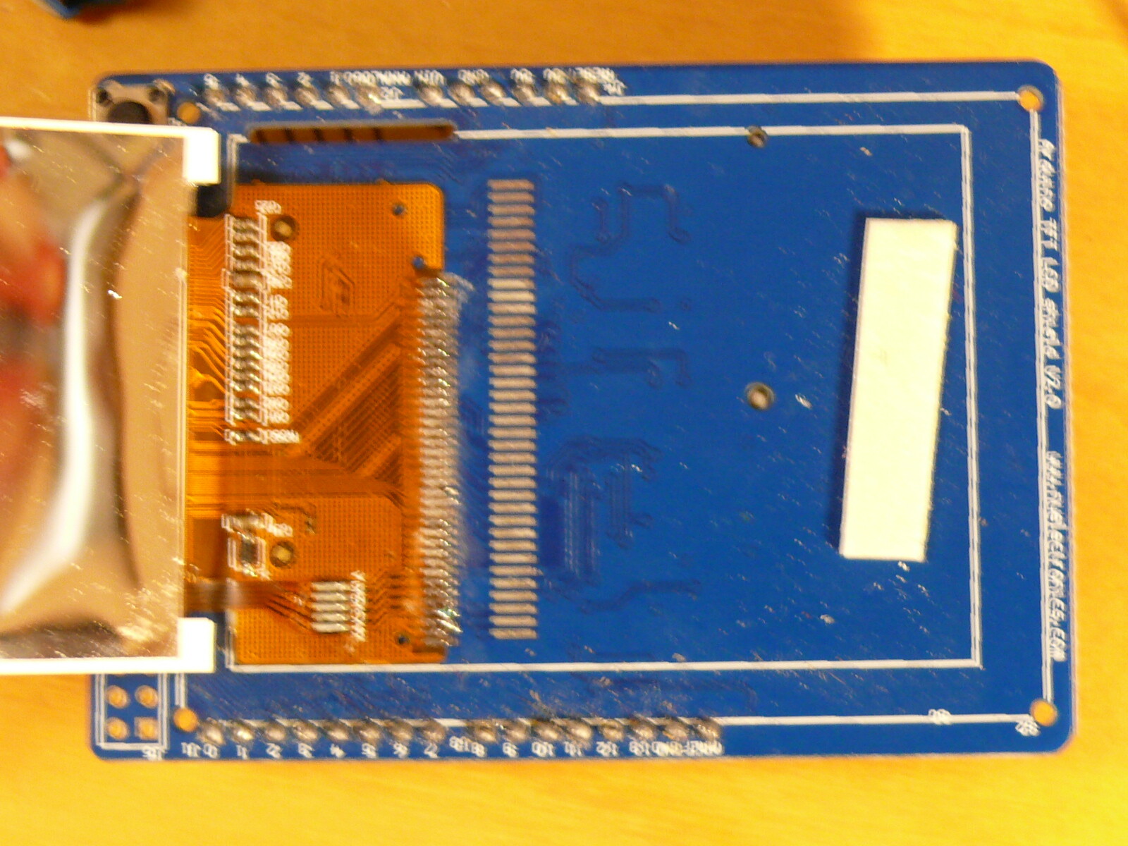

now a picture of the back side from pcb and from display.
chip numbers on older post.
I have displays since 2012 but never used and now I have some new projects and try tu use them...
helmut

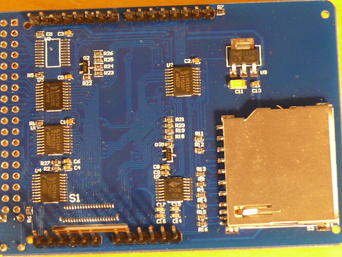

next picture...
it looks like 0-7 --> UTFT
ist it helpfool?
helmut
It appears that there is a LVC573 latch, and 3 LVC245 buffers. XPT2046 Touch controller, AMS1117 voltage regulator.
So the "driving" could be anything.
Google might help. Old UTFT might help.
If databus is 0-7, that leaves 8,9 for control signals. e.g. latch.
Life is a lot easier with 8080-8 interface and the Mcufriend pinout.
David.
