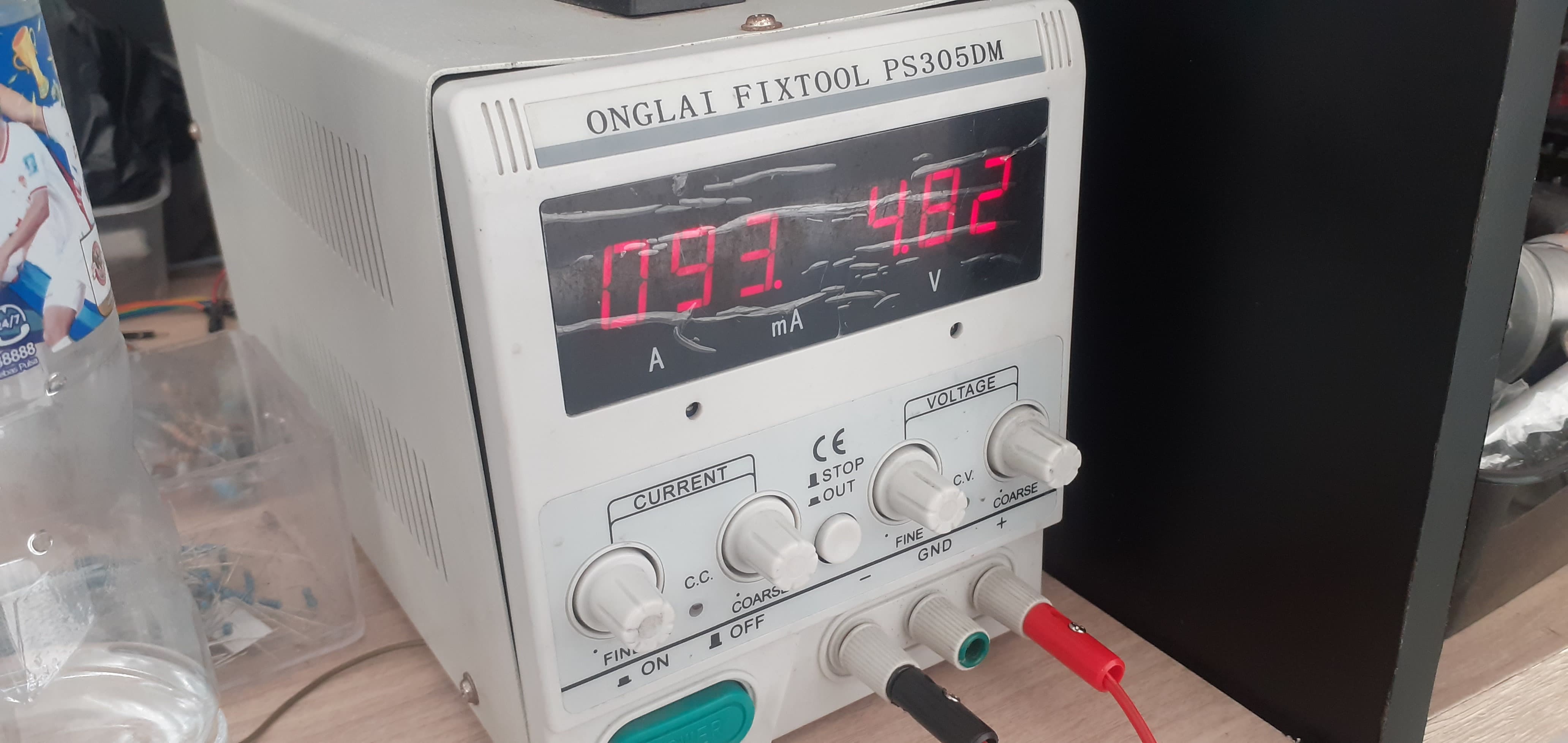

I use DOIT ESP32 Devkit V1 with ESP-WROOM-32 Module. The power supply I use is ONGLAI FIXTOOL PS305DM, it is a power supply that can be adjusted voltage.
To connect the source voltage to the ESP32 is to connect the + pin on the power supply to the VIN pin (in my case using 5V) or 3V3 (if I use 3.3V) and the - pin to the GND pin.

Adjusted current also I expect..
Are you sure you don't have current limited by your supply?
Well, I don't know about this. When I try to connect the ESP32 to the power supply, the power supply display always shows 93mA. I tried turning the knob of the electric current, but the result is still 93mA.
I don't have user manual for your power supply, but I expect you regulate the current like this:
Disconnect the leads from Esp and short them together. You should now have LED on cc.
Adjust the current to 1.00A. Separate the leads and adjust voltage to 5V.
Connect to Esp (VIN).

Don't limit the current.
An ESP draws that 93mA constantly, but peak currents during WiFi trafic can be >400mA.
Ifyou restrict supply current, then you will likely have issues with WiFi.
Leo..
Don't limit your current, as @Wawa says. Most devices will only draw the current they require (ofc LEDs and such do need current limiting resistors though). It's up to you to ensure the power supply of your choice can tolerate the amount of current your devices require at peak, times about 1.5 for overhead.
I see your power supply is set under 5V. If connecting to the VIN pin, I think you want to use 6V.
