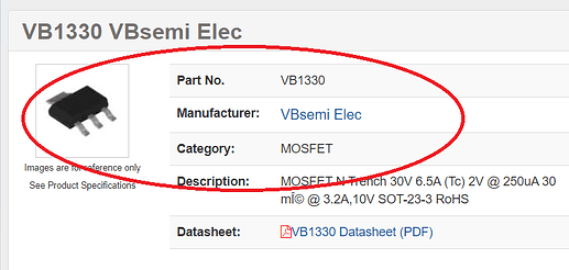

Thank you for your reply. Yes, we mainly output circuit design and applications of MOSFETs and other devices. If you need test samples, please send us a private message!:smiley:
What is your equivalent (or better because these are getting old) of the AO3400 and AO3401 mosfets which are often used in hobby designs? That is: Medium power. Low RDS(on) quoted at a low voltage.
Suitable for load switching
This is a hypothetical situation where a surge occurs. :smiley:
Yes. that is what I meant.
It could be a relay, a boost converter, a small motor, an H-bridge etc.
For medium power applications with low RDS(on) at low voltages, consider MOSFETs like the VB1330 and VB2355.
Advertising...
You can see that I asked him for a specific example out of that product range. It is not surprising that the manufacturer's name appears on any search for documentation.
