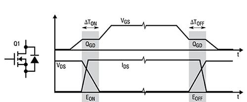

The moment the PMOS switch is turned on, the inrush current is too large and the PMOS burns out

The threshold voltage of the FETs can differ. With a common gate resistor the gates are connected and the transistor with the lower threshold voltage will catch all the current.
I have seen that as well, it stems from transistor where you had to add an emitter resistor to balance them. The MOSFETs do that thermally. Resistance in the gate lead causes the switching to slow down leaving the load in the ohmic region longer.
That is why you turn them on quickly and keep them in there SOA (Safe Operating Area). A gate resistor will form an RC with the gate capacitance and slow down on the turn on exasperate the problem.
The gate resistor protects the driver stage against too high currents while switching.
See my #4. This thread starts with a MOSFET killer circuit. Intended to increase the sales of the TO?
so are you saying to not use a gate resistor or
to use a low value 10 ohm gate resistor and one will suffice or
to use low value gate resistors one per MOSFET?

That's a killer approach. In contrast to a linear amplifier a switch has to avoid the linear region. High (capacitive...) switching currents have to be reduced by resistors or inductors in series to the load.

For MOSFET switching applications, we must operate in the ohmic region i.e. linear region.
An interesting point of view. However, here is a Load Switch (Texas Instruments tps27081a) where the user can configure the rise time with external components, a capacitor and a resistor, the capacitor being positioned between the PMOS drain and gate: https://www.ti.com/lit/ds/symlink/tps27081a.pdf?ts=1719061361032. There is a table of suggested values where the user can pack in an upto 1uF capacitor for a rise time of nearly 4ms.
Special loads can require special drivers. A general purpose switch has minimal rise and fall times.

You don't define Vin, but in general driving a MosFet via a 10k resistor is not a good idea. The reason is the drain charge will delay the transition from off to on.
Your very pretty waveforms unfortunately do not relate the reality of the situation, they simplify too much and don't consider the Qgd or the define the load or the input power supply.
