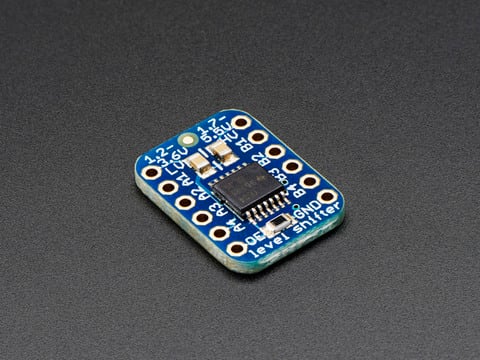

There is no one solution that fits all cases, so the most efficient will depend on the application.
Resistors might be OK for a slow speed digital signal but probably won't work for high speed SPI.
Level shifter ICs can be the best solution if you use the correct IC for the application.
The common level shifter that uses the BS138 MOSFET works well for open collector circuits like I2C.
Most 74LVC series ICs can be used as level shifters to go from 5V to 3.3V, e.g. 74LVC1G17
Many AHC type IC can also be used as 5V to 3.3V level shifter, e.g. 74AHC126, 74AHC244

For I2C this is the most common. You will see may different versions on sparkfun, amazon, aliexpress
Thank you, and also can you answer about SPI interface?
This is the easiest to use solution for SPI since it will work up to 20MHz but the connecting wires must be kept short.
The I2C level shifter will not work at the higher data rates
bidirectional logic level converter
