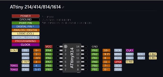

The search for a comparator better than the Internal Arduino comparator
I already know that the problems with the Arduino uno's internal comparator come from the lack
of hysteresis. So I used an ATtiny1614, which has a comparator with hysteresis.
I started testing the comparator with the simplest possible case. I apply voltages to its
inputs (+) and (-) and look at the output result - whether the LED lights up or
not depending on the relationship of the voltages at (+) and (-). But I don't see
any response from the comparator. I have tried everything and nothing. What could I be doing wrong ?
There is no help in the datasheet. The language for describing the pin functions is strange,
I don't find it in C++ or in the datasheet. What else can be done ?

Problem was solved due to 6v6gt.
You are missing connections, assuming the green blob is the comparator. Draw it is schematic form, that will give you the answer.
