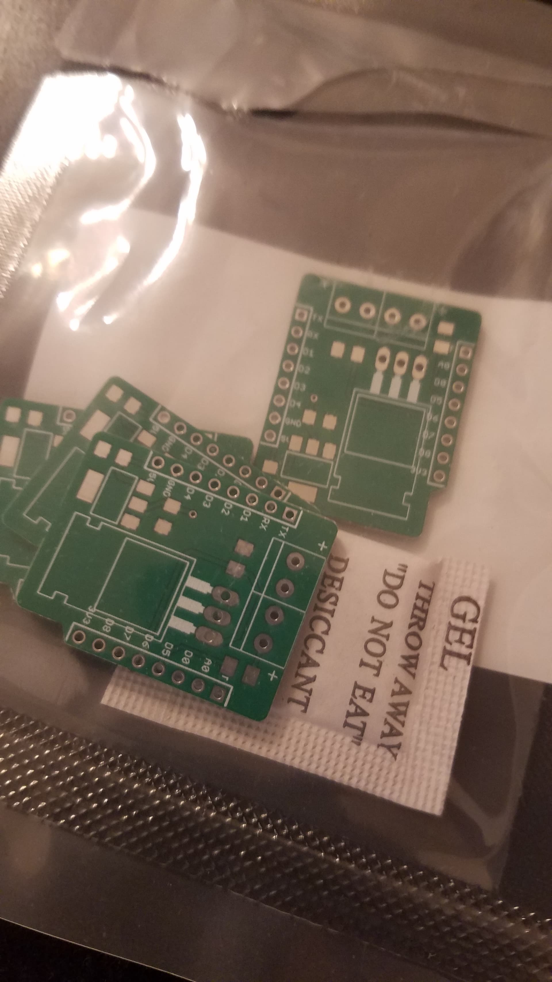

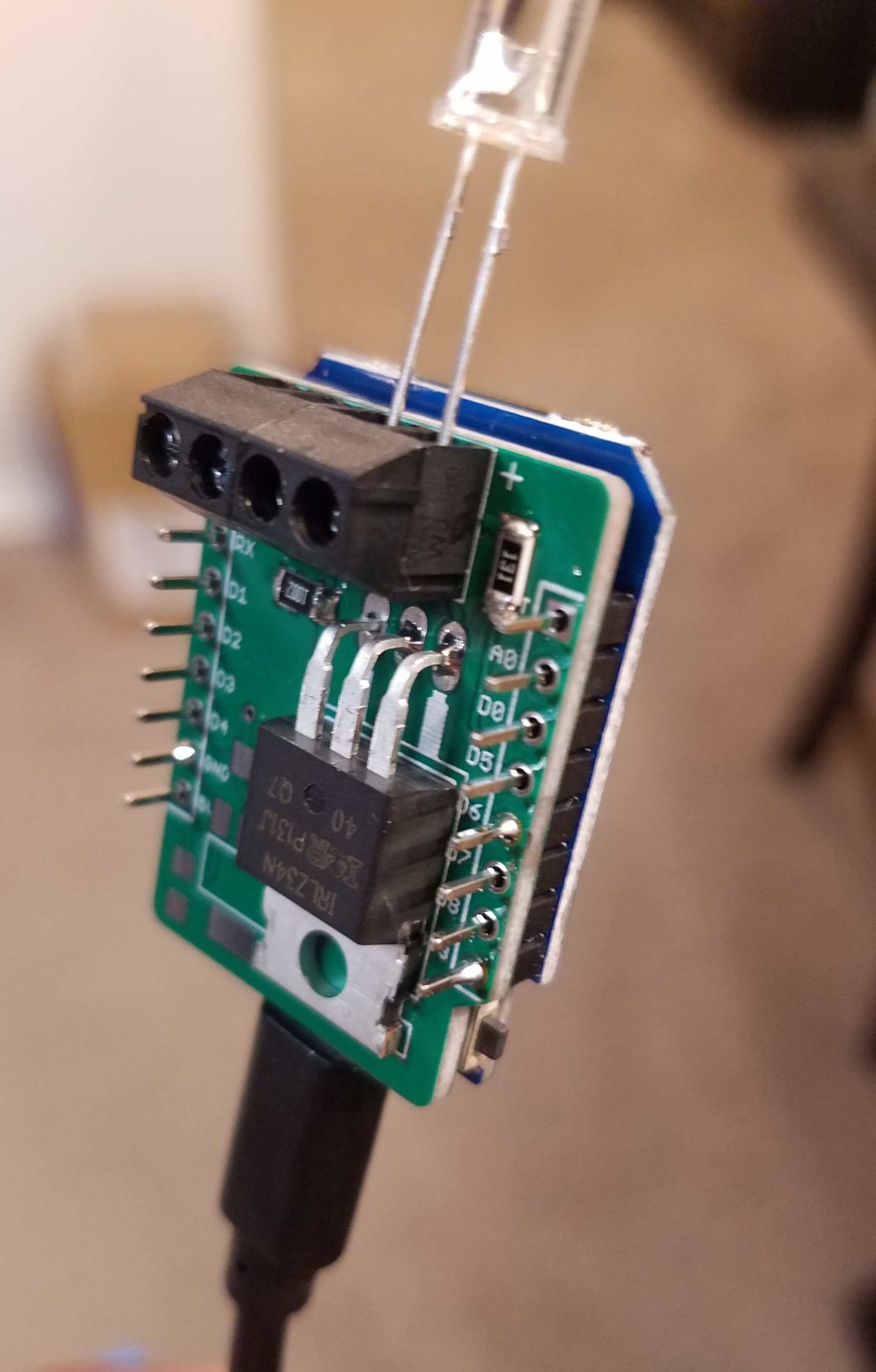

I finally got the pcb from jclpcb :slight_smile: For the first board I just soldered on the hexfet and 10k resistor (like from the sparkfun powercontrol) and made the solder jumper I added to power the project from the 3.3v D1 regulator and It worked as it did before but nice and compact! (same led dimming/turning off/ and back on during air freshener activation).
I ordered everything from mouser , including the tantalum capacitors of the 10uf rating per data sheet. Interesting they have a humidity constraint... packaging had desiccant, and a moisture? indicating card and label that said to use within 168 hours after opening sealed packaging. Another note said to look up instructions on how to bake them to get rid of the moisture... interesting!!
I wound up buying both 10v and 16v just incase. Board #2 was populated with the TI reg1117 regulator, 2 of the 10uf 10v cap's and it worked! these SMD are crazy small for my Weller 40 watt soldering iron and skills but it all soldered in and noting went poof :slightly_smiling_face:
By using the additional regulator powered from the d1mini 5v pin, it eliminated the led from turning off/dimming.
