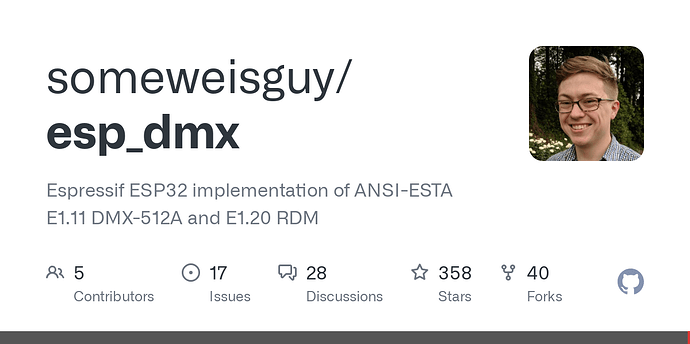

So I installed the esp_dmx library and it doesn't even compile. Why the heck don't they check these libraries to make sure they actually work.

Well it turns out that that error is known, and you have to roll back the Expressif library to make it compile. Brilliant.
Anyway, still didn't work.

The fault is at the people that create the ESP32 core. Version 3.x.x is causing issues for many sketches and libraries.
I am using version 2.0.11 but i have heard version 2.0.14 is also Ok. Chances are that at some point v 3.x.x will come with a version that fixes some issues that have been produced by the newer major version.
The people making the libraries make them to work with the most recent version at the time and the ESP32 is a relatively new core, and also still largely pre-compiled which means there is a lack of documentation for programmers as well as no way to modify and contribute.

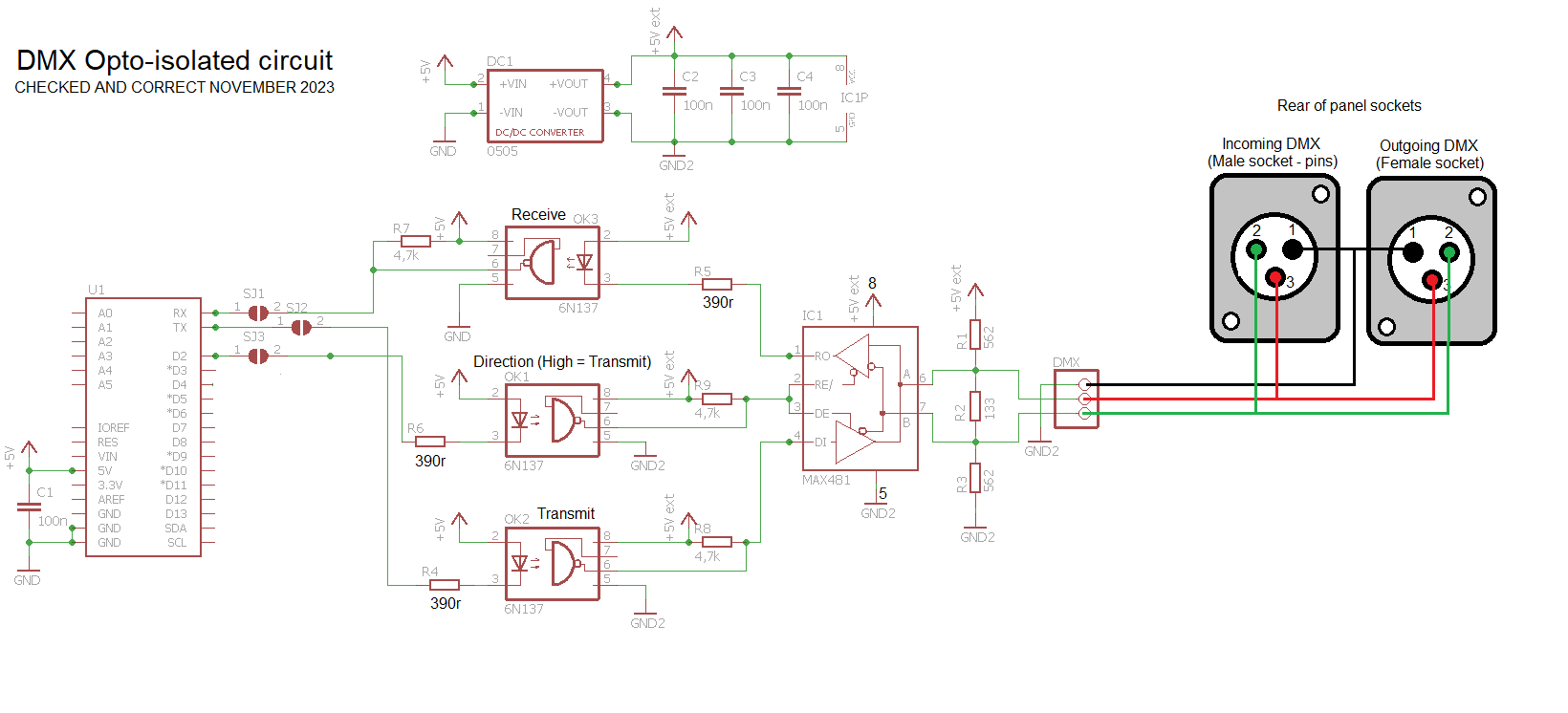

My issue is the resistor supplying the opto isolator.... I am sure of it
I have 6n137. What resistor value would you use to connect this to the Serial out of the ESP32? (bearing in mind it's 3.3v).
I thought 330r, but this results in the light flickering. Higher (470r) doesn't work at all.
I dropped it to 220r.... nope. Tried 150r and now I think the opto-isolator is dead.
I thought I did the led maths correctly.... clearly not
Why do you have an Opto-coupler on the output to begin with ?
Show me the full schematics.
There is no opto-coupler in a standard DMX circuit.
This is a screenshot of my DMX in and DMX out circuit for a 3.3v device (an ESP32 in this case, but all should work the same)
The MAX485 on the left drives DMX-out and is constantly in output mode
The one the Right is used for input and can be switched.
The pin numbers of the screw-terminal for the output are also pin numbers of the XLR-plug for the DMX cable.
Both Max485's are powered with 5v and the Voltage divider on the input reduces the logic level down to a safe 3.3v
Note the absence of a GND connection to the cable on the input side.
If it works with a teensy, it should work with an ESP32. They are both 3.3v devices. There must be another cause. Could it be just lack of 5v current supply ?
Anyway please post the full schematic.
I am entirely baffled.
I found what I thought was the cause this morning. I stupidly added a LED to tell me when the direction signal was high. This was holding the direction opto-isolator in an odd state.
Replaced the opto-isolators and deleted the led I thought we were going to be sorted...... nope.
I have used this circuit before with no problems. I just can't see what the issue is.
Not working on ESP32 or Teensy.
Has its own clean 5v supply.
DMX light is def working, as I have a DMX tester here and that works it fine.

I have currently got 220r resistors in for R4 and R6. Still nothing at all.
Could it be these need to be 100r? The isolators appear to work, so surely that means the 220r is doing it's job?
If I put GND on the transmit line, the output pin 6 of the 6n137 which is being held high by the 4k7 resistor, drops to nearly zero.
Same happens on the transmit Opto-isolator.
Not using the RX side of the circuit.
OK. For reasons I don't understand, the system works when you power the entire DMX system from a 3.3v supply.
This means the DMX 5v/5v isolator is now actually working at 3.3v, so I am going to have to check the specs on that.
I thought the whole system would be fine at 5v still, seeing as the only interaction between the DMX circuit and the Teensy is the Opto-isolator leds.
The DMX circuit before the opto-isolators and the Teensy share a common ground, so why should it matter whether the DMX Isolator is driven from the 5v rail or the 3.3v rail?
Don't get it.
That doesn't make sense at all. The transceiver should be powered from 5v, shouldn't it ? What does the datasheet say. Anyhow since the transceiver basically switches the polarity of the A & B lines for HIGH and LOW logic, the receiving end is probably OK with it (for small home testing ? ) I think the voltage difference between a & B is anyway something in the order of 2.5v..
Also doesn't make sense.
One would say so, but the RX-line is pulled HIGH with 5v, and that is not such a good plan on a 3.3v MCU.
The same goes for the 2 output pins that have to sink 5v - the voltage drop of the opto-isolator. I am sure that side of the module should be powered with 3.3v instead of 5v ! Chances are protective circuits on the ESP32 may start working and disturb the output signal.
If they share a common GND then what is the point of an opto-isolated circuit ?
Anyway, with this in mind, i would disconnect the RX line.
I would also select an alternative pair of GPIO pins in the ESP sketch and use that. It is an option and you may have even damaged the pins you used, though probably not.
Personally i would not have both an input and an output socket connected to the same transceiver, simply because this can cause 2 transceivers to be in output mode at the same time. 1 DMX master go into input mode for RDM communications, but i would not connect another Master to it. I that case i would always use 2 transceivers.
About the configuration of the Pullup-Terminator-Pulldown resistors on the transceiver twisted pair, that is probably a bit transceiver dependant, and with short lines and few devices it probably won't matter much, but in bigger setups this will require more testing.
I mainly built DMX-slaves and you don't want terminators on every device, just the one per chain at the very end, and the one on the master is really only there for RDM.
