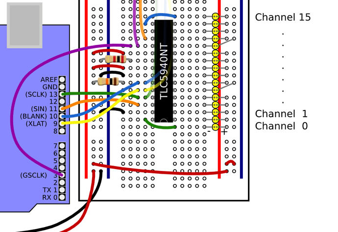

Please refer to my attachment for my wiring diagram and setup of the TLC... for testing purposes I am using an UNO and only 1pcs of TLC and copied wiring as to the photo.
When use TLC I cannot get the Mosfets to run my LED Strings and I read a post stating I need to pullup the voltage.
TLC5940 & IRFZ44N - LEDs and Multiplexing - Arduino Forum the Last Post...
I didnt know the TLC was not setup to drive mosfets and I read I need to pull up to 5v it is the TLC's outputs that need to be brought to 5v?
I tried this with a 1.5K Resistor only the LED String turned ON... (At the time of connection, only one of the 2 Colours should have been active but both turned on) so i am assuming didn't work.

This is how I setup MOSFET. exactly same way I would if I was driving them from the arduino pwm out 2,4,5,9,10,11
mosfet resistors are 10K
I also tried 1.5K & 10K on the Positive and TLC5940 output..
Ca you make a real schematic? This Fritzing mes isn't making it very clear. If you con't know how to do that on the computer(Fritzing can do it ;)) just use pen and paper.

Those chips are indeed not the easiest to use. Fine to drive small loads directly (the constant current driver in them is great for that) but driving mosfets get's complicated. I would jut switch them for a simple PWM chip like the PCA9685.
And I would also learn how to daw a real schematic

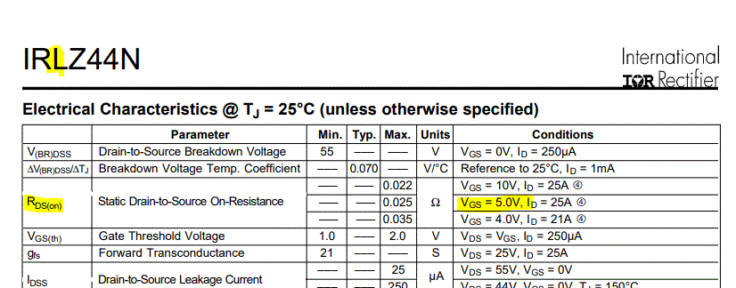

I didn't understand the half of all of that, but it might be worth pointing out that the IRFZ44 isn't a logic level transistor. You may be confusing it with the IRLZ44, which is.
IRFZ44 can work fine only keep in mind the limited current you can switch and possibly higher losses.

If the datasheet doesn't list a 5V Rds(on) surely you can't rely on it being a particular value and can't calculate what that "limited current" may be at 5V.
Why not just get the L-version?
It doesn't it there but you can see it in the graphs just fine
I agree, if you need to get one, get the L version. But if you pulled it from the spare parts drawer it's fine, jus look up the limitations.
septillion:
Oh yeah, good point, I always forget about the graphs, just look at the tables....

Hi Septillion,
Can you advise how to properly wire the IRFZ44 to the TLC5940?
If I can make the TLC5940 output to a ordinary LED. the TLC is working correctly. I only wish to use a high load LED string via the mosfet.
You mention it will work fine?
I wish to attempt one last try.
Thing is, a TLC5940 can only sink current. If you use a N-channel low side, you need a pull up on the gate to enable it and use the TLC5940 to pull it low. This will inverse the logic! And because the gate will only rise via a pull up this might give you some extra heat because of the slope.
The inverted logic means you can never turn the LEDs off completely. This is because in normal operation you never turn them on fully, but one step off full brightness which you do not notice. However on step off from zero you can see as a faint glow.
That can indeed be an issue. Easiest fix is to use P channel and drive high side. But that's not an option for common anode leds.
