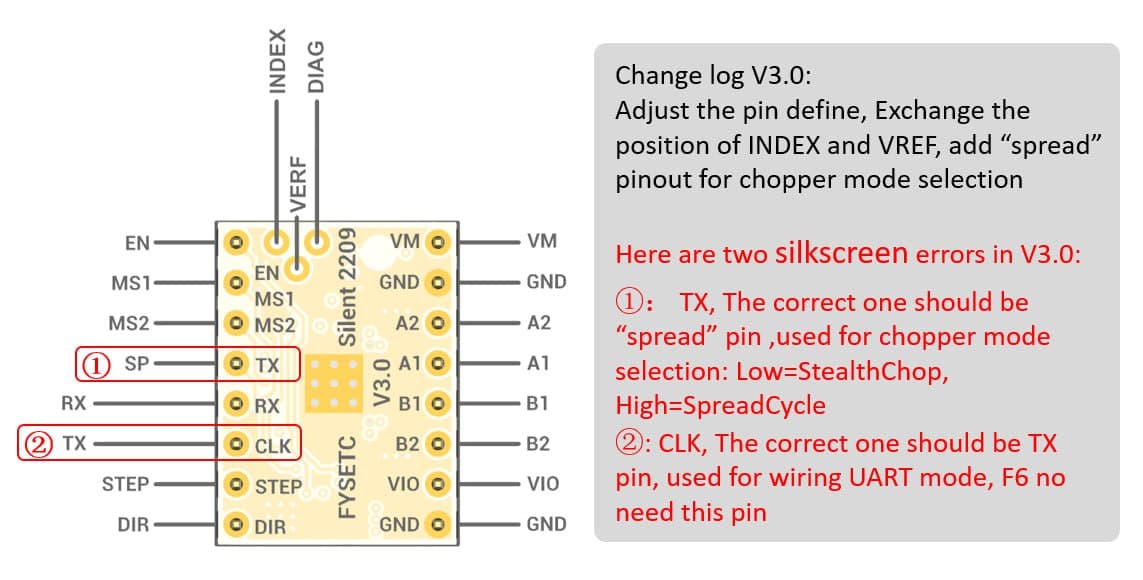

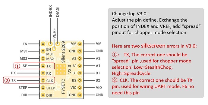

hi i have tmc2209 v3.0 and i was having trouble with my UART communication and i was reading some articles and and stumbled across this
https://www.reddit.com/r/3Dprinting/comments/y4n8tg/mks_robin_nano_v12_tmc2209_v30_uar
and i was confused if it is real or not if anyone know please let me know
this is my driver
and this also somthing i found in internet
and this
Is your driver made by FYSETC?
yes i don't know that's why i am confused i bought it from
there is no compny name
Many different companies make that driver. So if your driver is a copy the FYSETC circuit then it may be bad but who knows?

In the link this picture is junk
bad angle not really to see what this guy did.

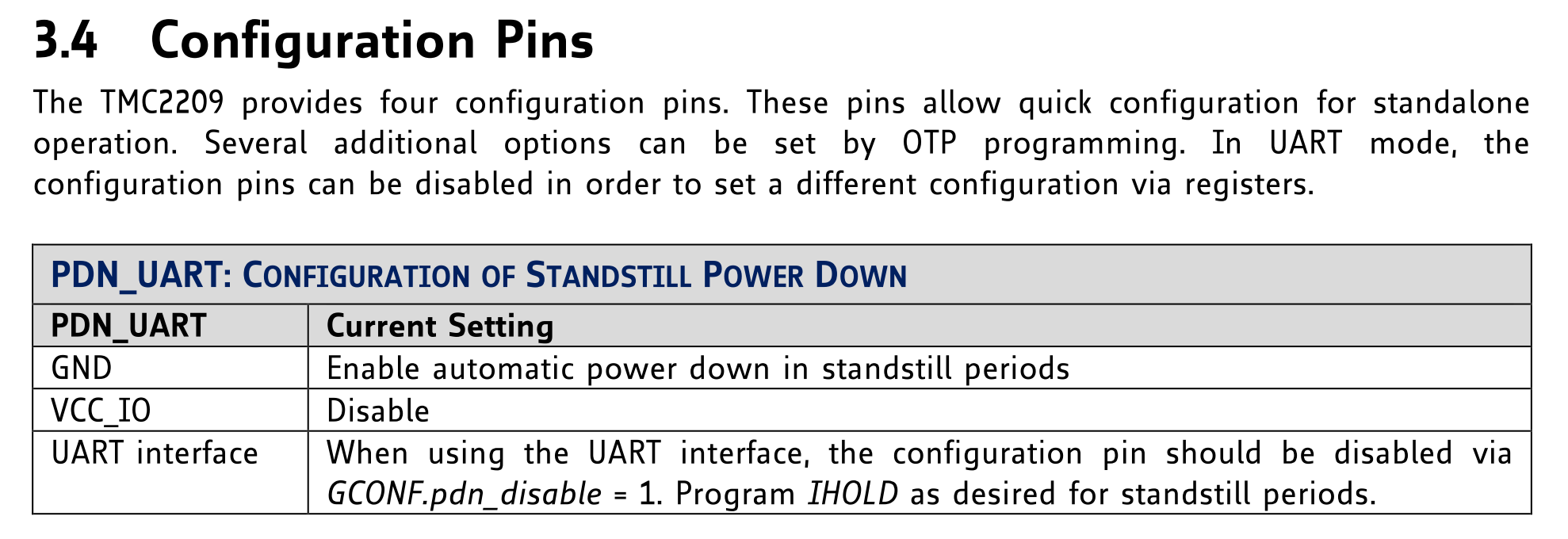

And it makes aboslutely no sense to shortcut the external clock-input CLK for the chopper with the Rx-pin
I guess this is a very crude way to do what is described in the datasheet:
You are connecting,
Tx of the controller to Rx of the TMC.
Rx of the controller to Tx of the TMC.

Thank you, I suffered for a long time and could not get it to work, it turned out there was an error in the name of the pins on the board itself and they did not correspond to reality.
After I connected it ignoring the silkscreen, everything worked fine.
I spent a lot of time on this and was very happy when everything worked out.
I wish everyone good luck!
How did you connect it, what are the correct pins.
