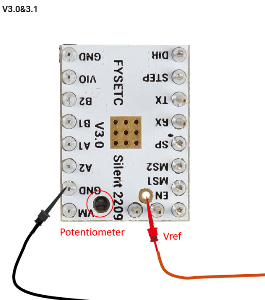

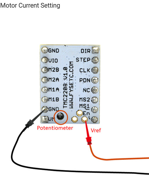

This is a wiki showing how to set it in a Silent2209 V3.0, and a similar for TMC2208 V1.0 (I have a V3.0)
The test points are different.

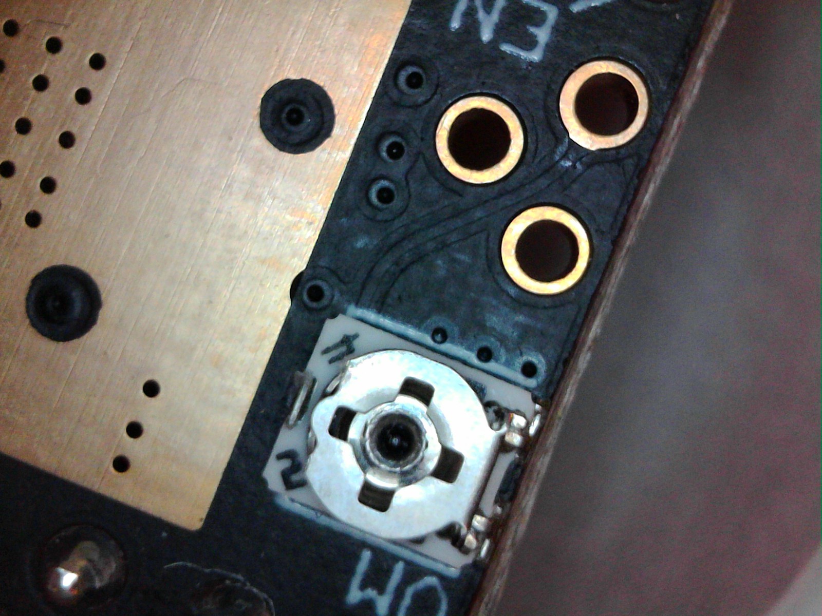

Update:
I did some measurements and VREF is connected to the lower right thru-hole (nearest the EN pin), and to the pot itself.
Under the microscope, you can see the trace from that hole to the pot.
