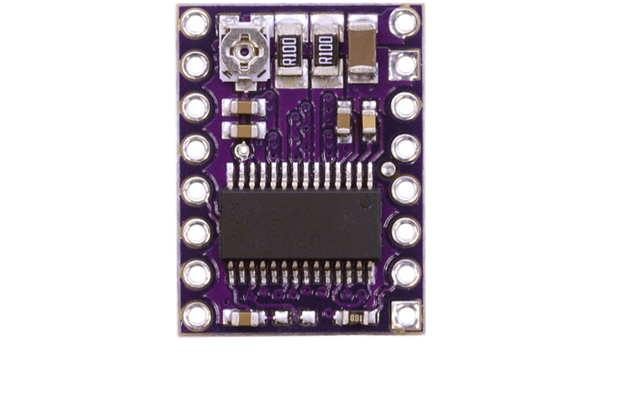

I want to use a DRV8825 to control a stepper motor, and I don't know where I have to put my multimeter to mesure Vref to set the limit current.

Also do I have to connect the GND of Arduino to the GND of motor supply?

Yes, grounds must be commoned - including for the Vref measurement - meter between Vref and ground.
thanks for your answer, but where is Vref on the board?
On the wiper of the preset pot on the board.
I am sorry Mark, but I'm not really fluent in english.
I don't know what is a wiper?
Could you please show me by adding an arrow on the attached schema where is it?
Also, when can I do this measure, I mean the DRV8825 should be powered On but the motor supply shouldn't be connected, is that right?

With a potentiometer there is a resistance track connected at each end to a terminal.
A third terminal connects to a movable contact that wipes over the track, hence the wiper.

I don't know why I decided to turn a very, very little the Pot on the DRV8825, I powered and nothing happened, I get back to the initial position and nothing again, I decided to check continuity with multimeter, and I find continuity between Vmot and GND!!!
Is my DRV KO?
You probably just measured the impedance of the decoupling capacitors that way. Check Vref without
the motor attached and power down, reconnect motor and then try.
I totally disconnect the DRV8825, and I find continuity between Pin Vmot and Pin GND.
I don't why because the driver was not hot at all!

I check the decoupling capacitors C1 (4.7µF), C2(0.1µF) and C3(0.1µF) on the DRV8825 board and it seems that they are shorted (continuity between the 2 extremity), do you have any idea about how is it possible?
