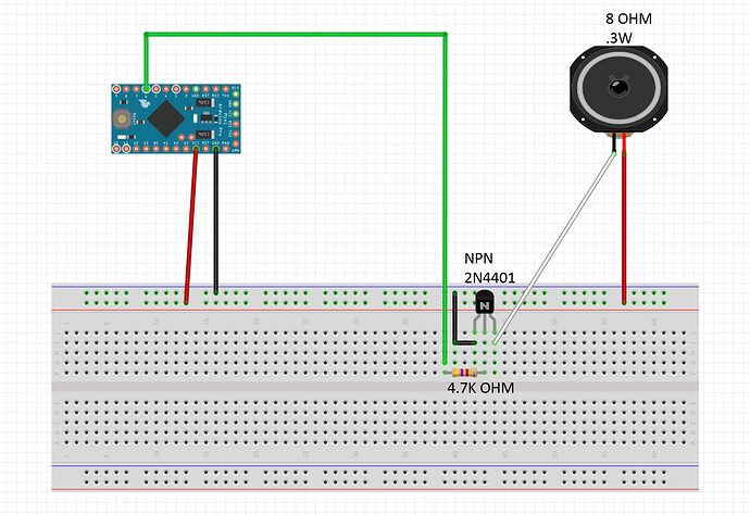

The pop is a DC shift in the signal. Try coupling it to your output device through a capacitor. Although that might not fix it.

Thanks for your reply. I've attached a diagram of the speaker configuration that I'm using. Could you suggest how to modify it based on your suggestion to use a capacitor to possibly eliminate the popping.
Thanks!
Robert
Try this one:-
Thanks G_M! Will give it a try.
