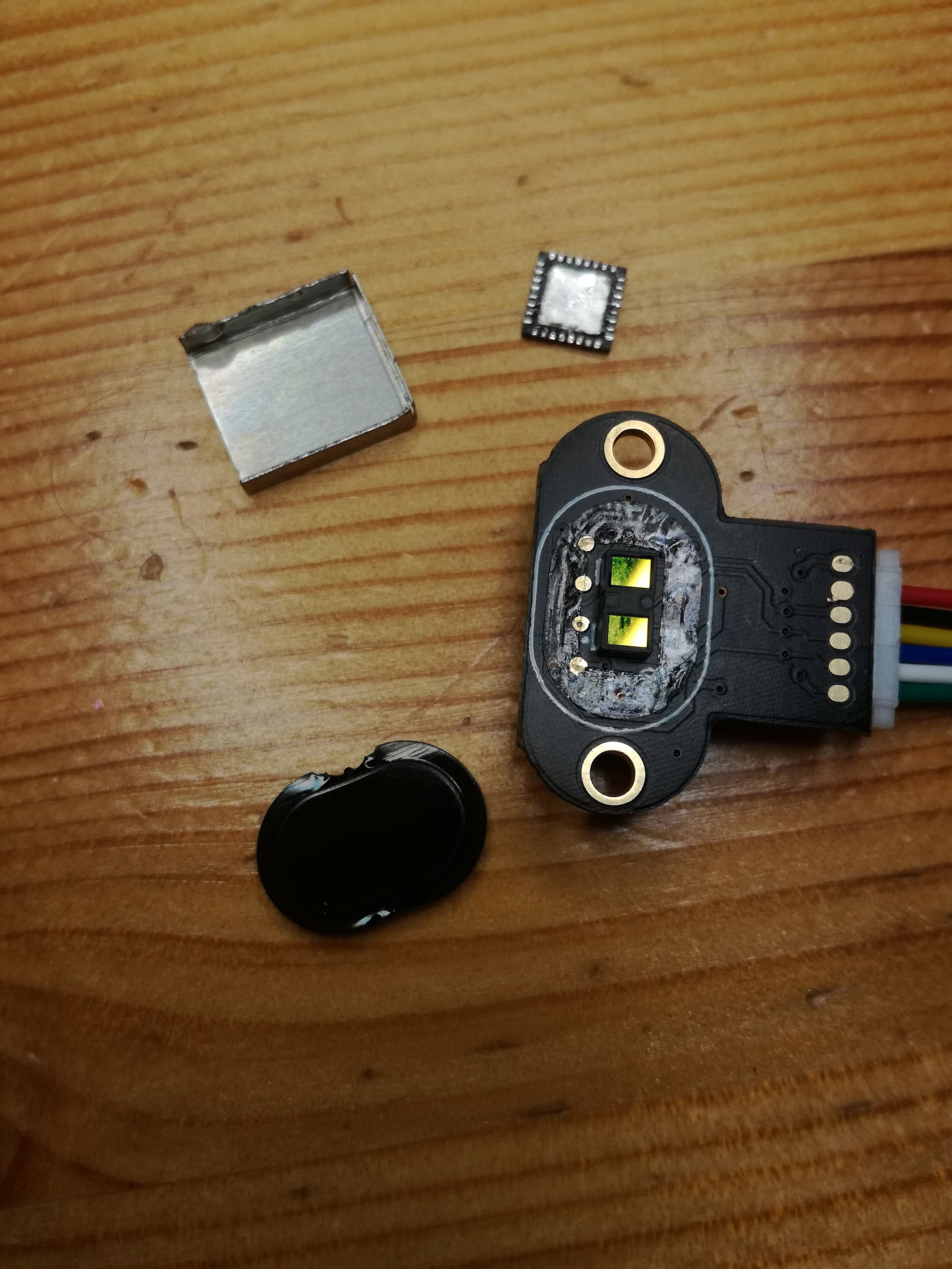

as the Link to the Raw Archive with the software is no longer valid, i decided to try an other way:
I desoldered the MCU cover and the MCU itself. (With soldering iron 400 degrees C)
Result: i can now communicate directly via I2C with the VL53L1X and it works perfect!
Tipp: remove the IR cover of the sensor before desoldering or it may be deformed by the heat. It is just attached with double sided duct tape.
BR
Alex
