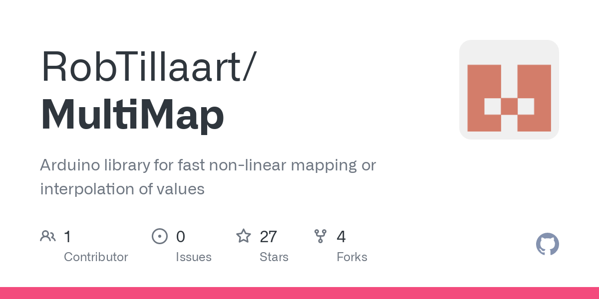

Thanks for that :+1:t3:. This library is in use and also reached out to the creator of library to specifically talk about his NTC thermistor example and he helped me along originally.
This is why I suspect as others have said,,, there are a lot of factors against me here,,, poor quality dividing resistors, ESP32 really does suck, i have no idea quality of thermistors either, I need to research and do a better job of calibrating…. At end of the day, not terrible results but not accurate as they are currently
