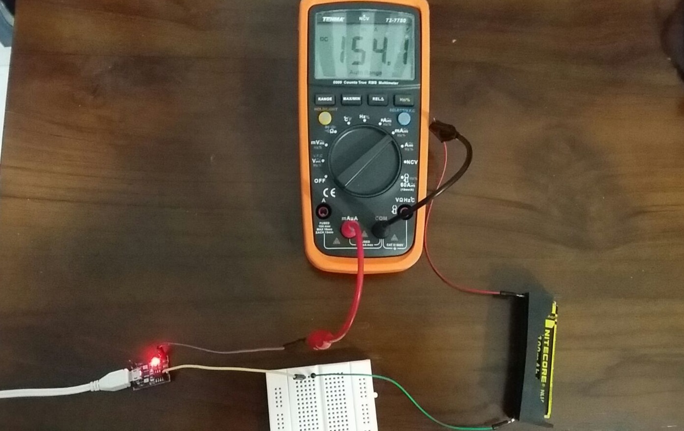

I was planning on making my own Li-ion battery charger using the TP4056. My setup for my charger is quite simple, I had my TP4056 hooked up to a 3.7V Li-ion battery (3100mAh), and I plugged the input of the TP4056 with my (5V, 2.5A) power supply. I had measured the battery voltage which was around 3.75V and was expected at least 600mA but found out that only around 160mA was pushed into the battery when I checked using my multimeter. Was there something that I missed in the setup?

My bad on that part. I have uploaded a picture of the circuit and the circuit diagram. Thanks for the response.

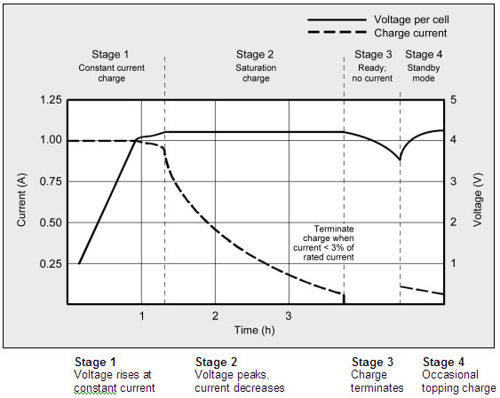

Li-ion discharge curves:
The current you measured is within the range of expected behavior for a trickle charge. I'm not familiar with the chip or module you're using, but it seems to be selectable on whether to go constant current or constant voltage. Pay attention to the time curve.
Nope, not for Li-ion chemistry, and that battery. BU-409: Charging Lithium-ion - Battery University

I do not believe that chart. Manufacturers very often misrepresent their batteries.
See the link in reply #6 for charge/discharge behavior.
The important thing to know is how the charger behaves over one or more complete charge/discharge cycles. Please continue with your experimentation!

Did you actually check the resistor value ?

Yup, the SMD resistor at Rprog reads 122 (1.2k), which i input into the Ibat formula given in the datasheet to give 1A. That is why i found it weird that the charging current was still so low, when it has not even reached constant voltage.
