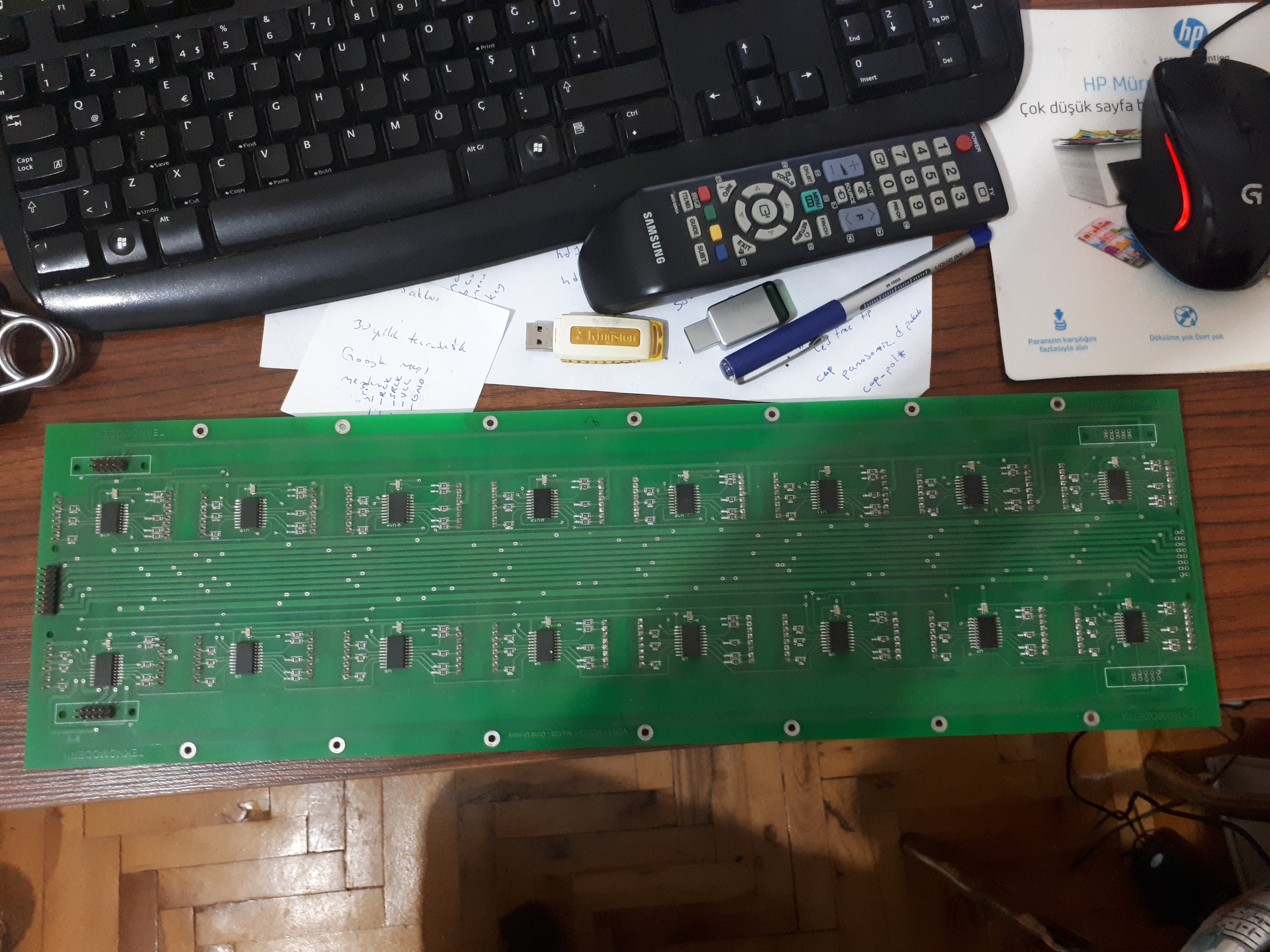

Fabulous, what im looking for thank you. i have dot matrix (8*8) there is a name on themLNM2088AU 010510 coudnt find any data sheet maybe C.cathode and on pcb s.regs. same as your design its old board with 2 pcss, each board 16 dot matrix nad total 32 im gonna try to run with arduino but i need to reverse it about 2 days which pin is which and gonna make custom power sup for it refencre your design, images:
Hi. It would be simple if you could "INVERT" the register holding the data to be outputted. I haven't tryed this on "byte-level".
I'll do this wery often with my programs, but I usually do it on a "bit-level".
Try something like this with the register holding your data:
(output_ data = !output_data) the excl. "!" stands for NOT.
