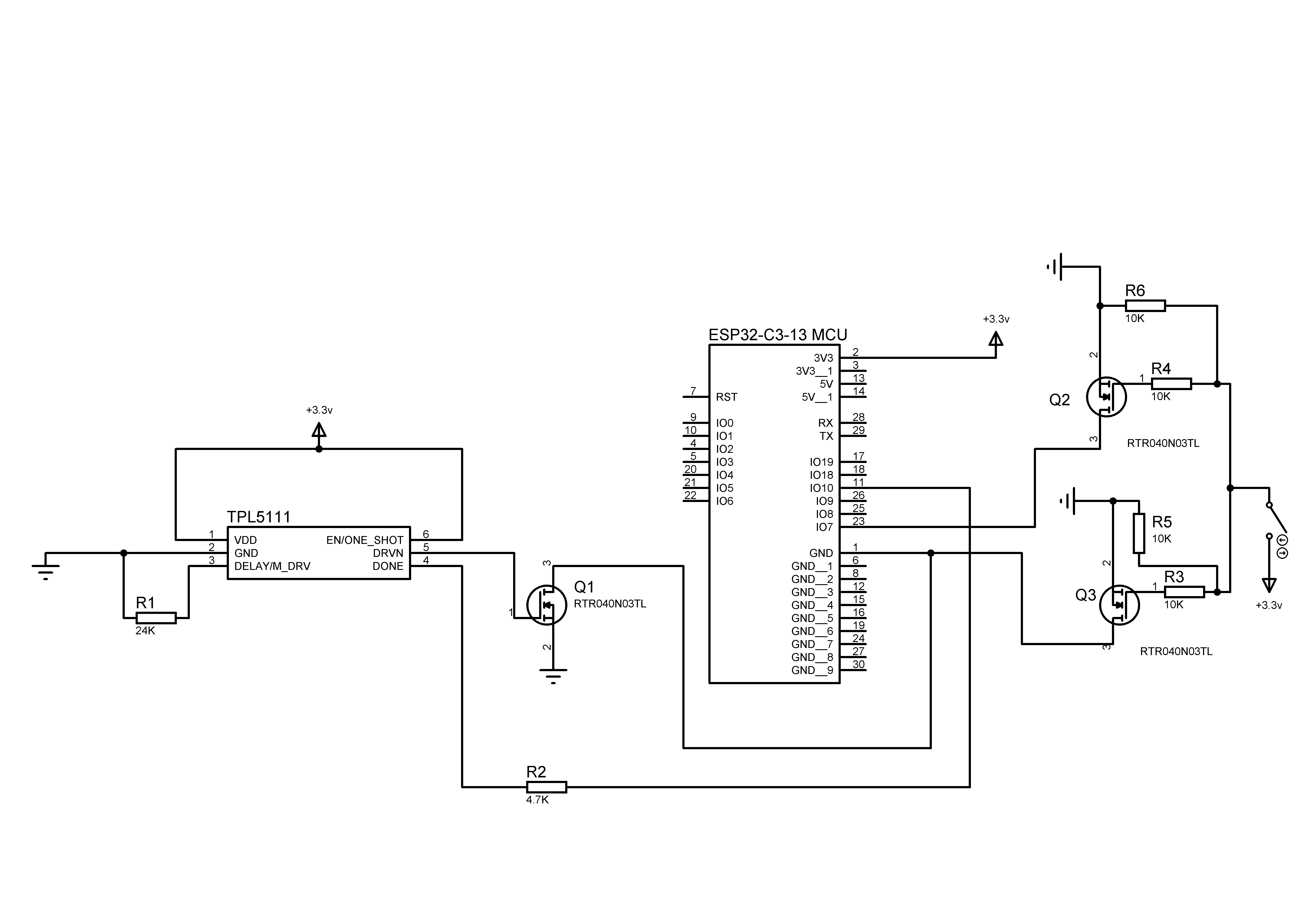

I am designing a new sensor circuit running ESP32-C3-13 MCU. I used TPL5111 in order to save battery power with RTR040N03 n-channel MOSFET for switch reason and turn off ESP by sending DONE signal over ESP32 IO10. There's no problem with this setup if I don't add one more RTR040N03 (top-right) and attach it to the GND. But when I attach to the GND, TPL5111 do not start and can't generate signal on DRVn to RTR040N03 gate and as a a result device do not work. Please find the design below;
What may cause to not run TPL5111?
Thank you for your support.

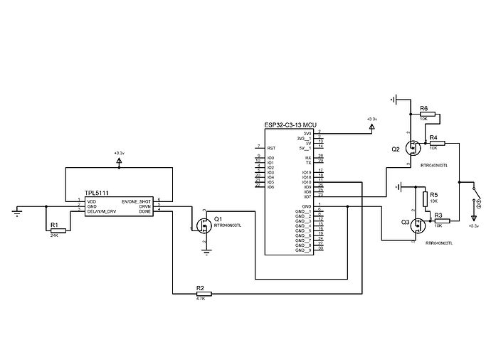

Please check this one. not previous
Please post a schematic diagram, with pin labels, not a board design.
Explain the symptoms of the problem, and what you have done to determine what is wrong with the design.
Hi jremington,
The circuit powering up by TPL5111 thru Q1 MOSFET periodically. Additionally circuit can be powering up by N-channel RTR040N03 MOSFET when the user push tack switch. The problem is when I attach R5 and R6 to GND circuit is powering up as expected and MCU understand that switch has been pushed by reading LOW signal on IO7 pin. But in the case TPL5111 is not work.
If I drop R6 nd R5 TPL5111 works properly but Q2 and Q3 not.
I hope that it i clear. Thank you for your support.

Do you mean just having R5 and R6 in the circuit, without pressing the power button, the TPL doesn't bring the Q1 gate high?
If you leave R5 and R6 in place, but disconnect IO7, does the TPL work then?
By the way, I don't think it's relevant to your problem, but you have R5 and R6 connected wrong. They should go to the other side of R3 and R4. As you have it now, you've created a voltage divider, and are only supplying 1.65V to the gates, which is barely above the maximum gate threshold voltage.
Yes, When I connect R5 and R6 to ground, TPL5111 does not bring Q1 gate high.
I didn't check this condition. But I dropped Q2, R4 and R6 from circuit. Only left Q3, R3 and R5. Same problem happened.
You are %100 right about R5 nd R6 connections. I fixed it and updated diagram regarding your warning. But physically R5 and R6 are connected as you mentioned.

Not according to the schematic diagram. You need to use high side switches instead of low side switches.
Q1 is not needed in any case. The TPL5110 module has a P-MOSFET built in, and is already set up as a high side switch.

I don't understand how the system could work even without those resistors connected. The ESP32 is connected to the 3.3V supply. If it is not connected to ground, then I think all of its pins will float up to 3.3V. If that happens, then I10 will always be high, always "Done".
But I guess I'm wrong about that. In any case, the Done pin is the only thing I can see that could affect the TPS's operation. You might try measuring the voltage on that pin to make sure it's normally low, and only goes high at the right time. Perhaps the TPS is generating the high output, but immediately turning it off because Done is high.
I'm just guessing here, but this kind of problem is what everybody seems to run into when trying to switch the low side. Your comment about having problems with the TPL5110 is surprising since it should be a simple setup driving a P-channel mosfet.
Most likely because you were making mistakes similar to those shown in the schematics above.

Hi ShermanP,
Yes, you are exactly correct. I measured IO10 and see that pin has voltage. Because of this as you mentioned that TPL having "DONE" signal and turning off the circuit. Thank you for your help. I will try to solve this problem.

You need to use high side power switches, as already mentioned. One of the Pololu Power Switch examples would be a better choice for the ESP32 than the TPL5110.
