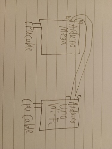

The situation is that I have 2 Arduinos (an Arduino mega and an Arduino Uno Wi-Fi), I have been trying to send signals over wire using the wire library between them both however, I am just getting zeros on the other end. Which tells me the message is not getting through. Please could you advise how I can resolve this problem.
I've checked that the pins are set correctly.
Many Thanks

Really? Address 0 is a reserved address.

Please post a hand drawn wiring diagram, with pins and all connections clearly labeled.

Here's my diagram attempt:
It's an Uno WiFi rev2
A ground connection between the two boards is required.
Which "Arduino Uno WiFi"? Triple check which are the SDA/SCL pins.

I've realised I've got confused between serial and I2c, I think serial would work better. I've found SDA and SCL on the Mega but I can't find them on the Uno WiFi (which is definitely a rev 2)

Does the ATmega4809 have just one Serial port ? Are you going to use SoftwareSerial ?

I see. Thanks. The ATmega4809 has four UART ports, and Arduino selected one as a spare hardware port on pin 0 and 1, called "Serial1". The Serial Monitor is via other pins. That's very nice :sunglasses:
So the drawing in post #4 is correct. Add a GND wire, and it works.

Thanks for that, I've added the ground and it's working. In terms of I2C, I'll have a look at it but it might be too late as I've been working on this for a long time.
