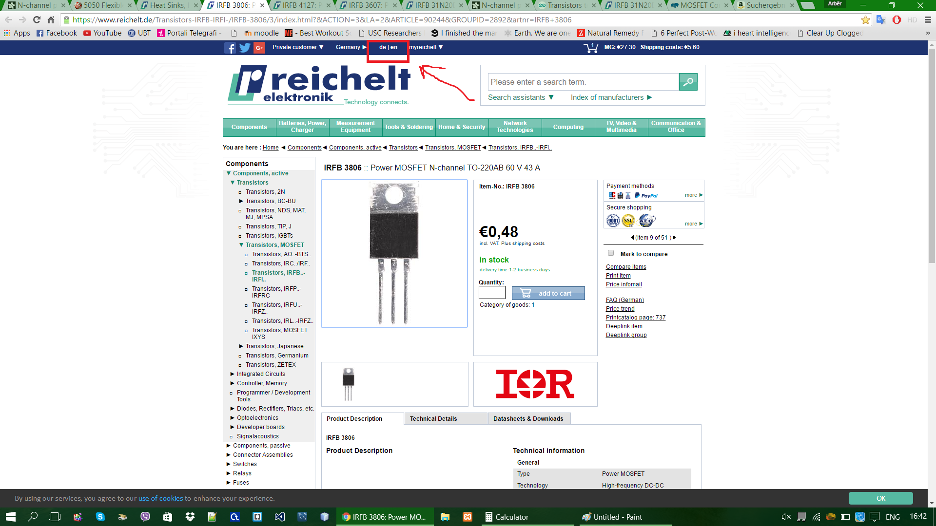

Can you help me to find the right one in this page please?
https://www.reichelt.de/Transistors-MOSFET/2/index.html?&ACTION=2&LA=2&GROUPID=2889
It would be a great help, because I'm not sure which one should I use. :slight_smile:
Thank you very much!
Sorry, I don't read German.
raschemmel:
They have an English version of the page too :slight_smile:
If you can help me please .

I found these Logic Level Gate MOSFETs:
https://www.reichelt.de/Transistors-IRL-IRFZ-/IRL-3803/3/index.html?&ACTION=3&LA=2&ARTICLE=41757&GROUPID=2896&artnr=IRL+3803
https://www.reichelt.de/Transistors-IRL-IRFZ-/IRL-1004/3/index.html?&ACTION=3&LA=2&ARTICLE=41750&GROUPID=2896&artnr=IRL+1004
https://www.reichelt.de/Transistors-IRL-IRFZ-/IRL-540N/3/index.html?&ACTION=3&LA=2&ARTICLE=41761&GROUPID=2896&artnr=IRL+540N
https://www.reichelt.de/Transistors-IRL-IRFZ-/IRLIZ-34N/3/index.html?&ACTION=3&LA=2&ARTICLE=90364&GROUPID=2896&artnr=IRLIZ+34N
https://www.reichelt.de/Transistors-IRL-IRFZ-/IRLIZ-44N/3/index.html?&ACTION=3&LA=2&ARTICLE=41768&GROUPID=2896&artnr=IRLIZ+44N
Which one do you think will work best if I want to power 3 meters of leds! (twenty segments per meter for the 60/LED per meter strip) = 1.2 Amps per meter)
