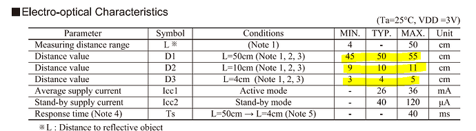

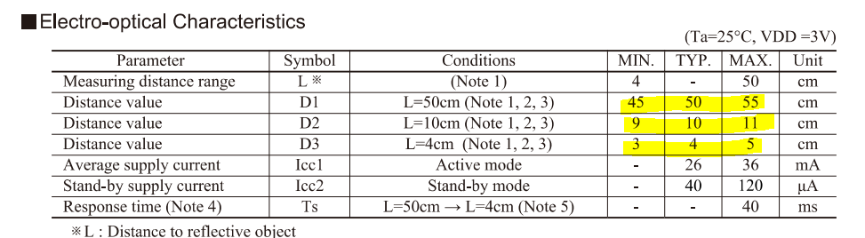

Sharp has a few low budget options, like this one: https://global.sharp/products/device/lineup/data/pdf/datasheet/gp2y0e02b_e.pdf. But there is no statement on the accuracy/resolution. Has anyone experience with these triangulation sensors from sharp?
Or any other suggestions on triangulation sensors?
Hi, @vhbrijk
Can you tell us what your project is and why the precision of 10um.
The datasheet indicates low precision, and no accuracy info
