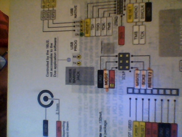

Had you correctly identified the pin numbers on the ICSP header I wonder ?
This is the schematic I followed. The schematic label MISO2 MOSI2 and SCK2. Is that correct?
I cannot read any of the text
There is a much better image on this page https://www.arduino.cc/en/Hacking/Upgrading16U2Due that puts the pin layout in the context of the Due
Thanks. That is what I've got as well. So it should work? I'll double check the hard wiring.
Ive soldered the leads to the ICSP MOSI2(white) MISO2(blue) SCK2(brown)
Its still not working with the ICSP. The card work when connected to the SPI.
Untitled 1.pdf (70.5 KB)
I found this link: The 21st Century Digital Home: Arduino Due Hardware SPI
ICSP on the DUE is NOT for MISO MOSI or SCK use.
