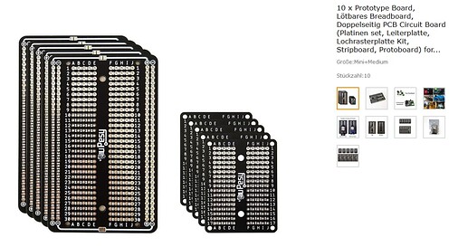

Hello michaelwillems
I´m using this boards for prototying.

I use strip-board. Like here:
https://create.arduino.cc/projecthub/michaelwillems/simple-bench-signal-generator-e560d0?ref=user&ref_id=1877097&offset=0
But this is even before prototyping: breadboards are the initial step, when I verify that it works; that my calculations are right, and so on. I can't solder yet because I have not yet verified the project, at this stage.
Some of the components have rather slim legs. Low cost bred boards.... No surprise if there are bad contacts.
Use protoboards and soldering as @ paulpaulson suggests.
