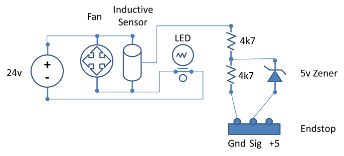

Hey folks, I’m using an inductive sensor in my 3D printer and seeing behavior I don’t understand, wonder if anyone can help.
I have a 24vdc power source and am wiring the sensor in parallel with a small fan, and the pair in series with an LED. The fan and sensor are nominally 24v parts, the LED is a 12v part.
On the sensor signal pin, I have a voltage divider and a Zener diode to protect my arduino input. I have attached a “schematic” (sorry for powerpoint mess!) to this post and a link to the ouput section of the NPN sensor schematic.
So what I’m expecting is 5v when the sensor is not activated and 0v when it is activated. What I’m seeing instead is 5v either way. Actually the signal goes slightly up when active - something is changing when active but not in a good way…
I measure 10v drop across the fan and sensor, and it doesn’t change when the sensor is activated. Then I measure 14v across the LED, and it also doesn’t appreciably change when activated. Just can’t figure out how 5v is getting to the signal. Thinking maybe I need another diode in there but would like to understand better what’s going on.
Thanks for any help you might provide.
Here’s the link to the sensor (it’s the NPN one!)
http://www.aliexpress.com/item/PL-05P-DC3wires-FOTEK-sensor-PNP-output-voltage-square-typoe-by-express-or-forwarder-UPS-shippment/361583254.html
There is, basically, nothing correct about that schematic. If you have connected things even approximately in the indicated way, you risk destroying the Arduino.
  1. Connect all the grounds together.
  2. The fan and sensor should NOT be connected through an LED to ground. The LED is not needed.
  3. If the sensor output really is NPN, then you need a pullup resistor from the output to 5V (suggest 10K) and you don't need a voltage divider or a Zener diode.

Thanks for the quick input, let me make some clarifying remarks...
First, I only have one 24v pin to power these three items, that's what's left of a multiconductor shielded wire to the effector of the printer. It's hard to pull more wires up there at the moment so I'm trying to get that done this way.
The LED is desired, it's lighting the work area under the effector. I've put it where I have in the circuit because it's a 12v LED, I'm already overvolting it a bit at 14v but it isn't getting warm - might shorten it's life a bit.
The board (it's 32 bit AVR based so "Arduino" might be stretching a bit - it does have 5v inputs though) I'm using has firmware settable pullups, which are enabled so I don't think I need an additional one.
I had a previous sensor wired by itself which did deliver 24v and I did have a 4k7/1k divider and it worked great. However, with the fan and LED sharing the power, the previous divider dropped too much and wouldn't trigger the input. I decided to use a 2:1 divider since this curcuit now feeds ~11v through the signal, not 24; but use a zener just in case the sensor ever did somehow send 24 volts, like me shorting something by accident :-0
But, I'm probably using the zener incorrectly. I did wire it according to a schematic I found online, but I don't have that link handy to post. Can you say more about what looks wrong about what I've done? Or maybe a link to a different/correct way to wire it?
It's possible that the grounds are an issue as I'm not 100% clear what's going on inside the board. I do believe though that the gnd of the endstop input is ultimately connected to the power supply (-). I guess there isn't a true ground anywhere except all the way at the supply where it connects out to grounded 110vac. The 24v I'm sending to the fan/led/sensor does come from a different output from the PS, it's just easier to use the other tap, but that might be bad.
Perhaps the ground is not an issue. However, it is not a good idea to wire anything but an appropriate resistor in series with the LED. The sensor will not work correctly, wired as you have it now.
For Zeners, see this link Zener Regulators
The LED is actually a small strip with the appropriate integrated resistors. This strip is designed to be daisy chained with other similar LED strips and so I think it should be OK to wire it as is. Basically the fan and sensor and LED all work fine, and it's probably just the zener and the input itself that I'm not fully understanding how to make work together.
I've actually read a bunch of information about zeners, but somehow not quite getting it and I've not been able to apply what I'm seeing there to the situation at hand. Most of them seem like application notes for protecting against overvoltage on a power input and this application isn't exactly that. These schematics often show the "load" meaning the thing to be powered, but I'm not sure what the analog is here. I'll take a look at your link as well, thanks.
I keep getting twisted around in trying to reason through the input and the sensor - the sensor is trigger low, so it nominally puts out whatever voltage it's given (in this case approx 11v), then when actuated, it drops down to less than one volt.
The input on the board must be set inverted in firmware (which it is) so that when it sees 5v it is untriggered and when it sees 0 it is triggered.
I can't quite see how to use the zener here, and I want to, as Vcc is 24v, if it gets to the sensor and through it's output at some point I wouldn't want it to fry the input. A voltage divider doesn't seem to be enough unless I'm sending the full 24v as before and can use the 5:1.

OK, I think I understand at least what's happening but not yet what to do about it...
I'm expecting the sensor to drop from 11v to ~0, but in fact the sensor negative is elevated from the board ground by 14 volts so it actually is dropping its output 11 volts but from 24 to 14. 24 and 14, when cut in half through the voltage divider are both above 5v, hence always 5v showing.
So, the zener (if I could figure out how to use it) wouldn't be "needed" after all because that sensor is dropping the full 24 volts anyway. However, the original 5:1 divider won't work because 14/5=2.8, not enough to register low. In fact, there's no two resistor divider that will get me above or at 5 on the high side and below, say 1 on the low.
Maybe there's a more complicated divider and/or a zener application that will get me there.
I have a different idea, instead of making it more complicated, make it simple for yourself.
If the fan, sensor, and LED strip all run of around 12V instead of putting them in a convoluted series/parallel combination why not get a 12V regulator and run all three from the regulator in parallel.
You can easily get a 12V switching regulator capable of delivering high currents if you have proper heat sinking etc.
Then all would be in parallel and getting a steady 12V and referenced to ground.
I recommend the approach above... but you could probably find a way (albeit more of a hack) to make it work with your current setup.
If sensor were powered from 12V and referenced to ground, then you could easily hook pnp output to arduino pin using either a voltage divider with appropriate scale of maybe 1:3 so 12V would turn into 4V on arduino input pin (and of course when pnp goes low you will get 0V on input pin so long as the divider resistors you use dont overpower the high impedance resistance of your avr development board
If you can't/dont want to get a 12V regulator a possible alternative would be to flip the LED and fan/sensor combo in the circuit. So LED will drop 12V or so (from 24V down to 12V) and then fan and sensor will drop 12V (12V to GND) but they will then be ground referenced and so a low on your sensor would in fact be GND not floating up at 12V
