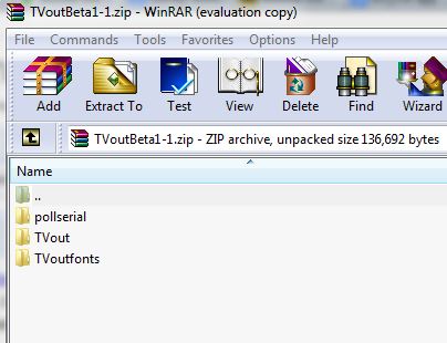

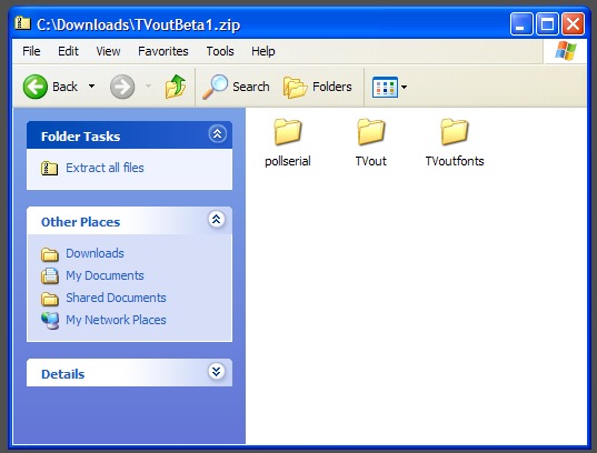

It sorta looks like you might have "installed" these libraries by saving the web-formatted source instead of getting the raw source.
Try deleting all of the tvout libraries that you have currently installed, and then re-installing based on:
Go to the google code download page and download the TVoutBeta1.zip file:
http://code.google.com/p/arduino-tvout/downloads/detail?name=TVoutBeta1.zip&can=2&q=
Open that and copy the three sub-directories (pollserial, TVout, and TVoutfonts) to your Documents/Arduino/libraries directory.
Start the Arduino, and you should see File/Examples/TVout/DemoNTSC, and it should compile OK (some warnings, but successfully producing an ~18k sketch...)

I didn't see any of these subdirectories, but TECH GEEK (as seen here: TVout: NTSC and PAL Composite Video Output. - Displays - Arduino Forum ) didn't seem to have any trouble finding them.
Exactly which file did you download?
The one you recommended, this one:
But you didn't see the (pollserial, TVout, and TVoutfonts) subdirectories? Weird...
Please tell me if you see those libraries.
Trying to show GUI interactions in a text forum sucks...
Here we go...

...and all I see in it is TVOut, which in turn is a complete single library.
This is what I get in the ZIP file you linked to ?
Magicj:
WTF? Using Peazip, all I'm seeing is TVOut!
So apparently Peazip failed me (neither of the other two libraries were being detected!). Just installed the libraries, so I'll edit this post once I test out the demo program again.
