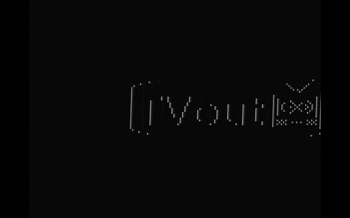

I built this plugged it in the tv and nothing happened. I cheked my circuit, centre pin through 1k to pin 9 ,centre pin through 470r to pin 7 ,. For some reason the pal woks better than NTSC though I live in canada where NTSC is used. see attached pics for result of tests. in pal i can barely see the text and it moves diagonally. can someone please help make it work?

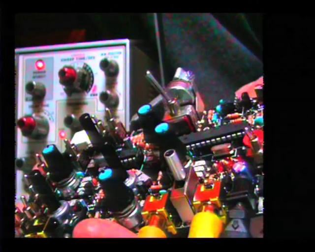

Hi, I would like to ask if is possible to mix output of Arduino TVout and composite signal of videocamera?
I would write a bit of information superimposed on the camera image.
See attachment for example.
Yes, the Video Experimenter shield allows you to do exactly that (and many other things).
This project shows text/graphics generated from TVout being overlayed on a composite signal:
http://nootropicdesign.com/projectlab/2011/03/20/text-and-graphics-overlay/

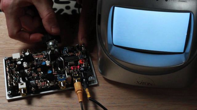

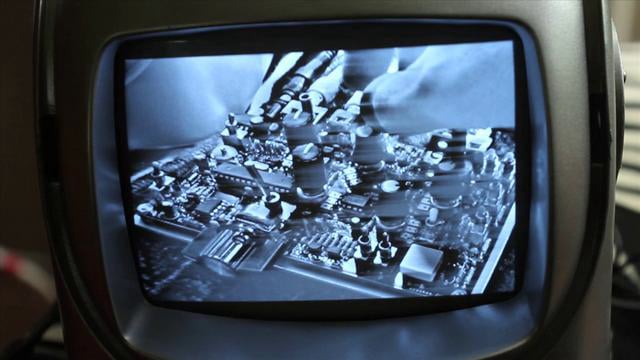

here is a video mixer i made with a modified version of the tvout lib
