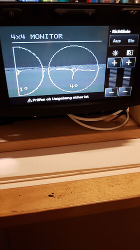

I am planning now a project for my car, and want to give some info via TFT on my car radio (using the RVC input). This TFT need NTSC and working well with a RVC (in colour).
At home I use a simple 2" TFT and the video output from Ardiuino is working well:
Then I connect it onto car radio RVC input and get no screen or a screen without any movemend and seems like not in sync / get freezed frame:
I try with some changes of timings in VIDEO_ROPERTIES.H but best result was a shifted screen from top to bottom:

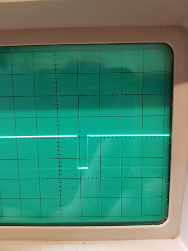

I check video signal of RVC (colour but slose the camera to generate a black screen):
Same with TVout and black screen:
As I can see the difference seems to be the burst-signal (maybe only need for colour?).
So I guess the video decoder inside my radio (TWC9900) need that burst?
But then why it is partially working? see video.

I've never seen a display device that requires a colour burst, but I have seen a few that require a correct sequence of equalisation pulses during vertical blanking.
In The Good Old Days of analogue displays, you could feed them just about any old junk, and you would get a reasonable display, but some modern displays require a fully standard compliant signal, and not all libraries provide that.
