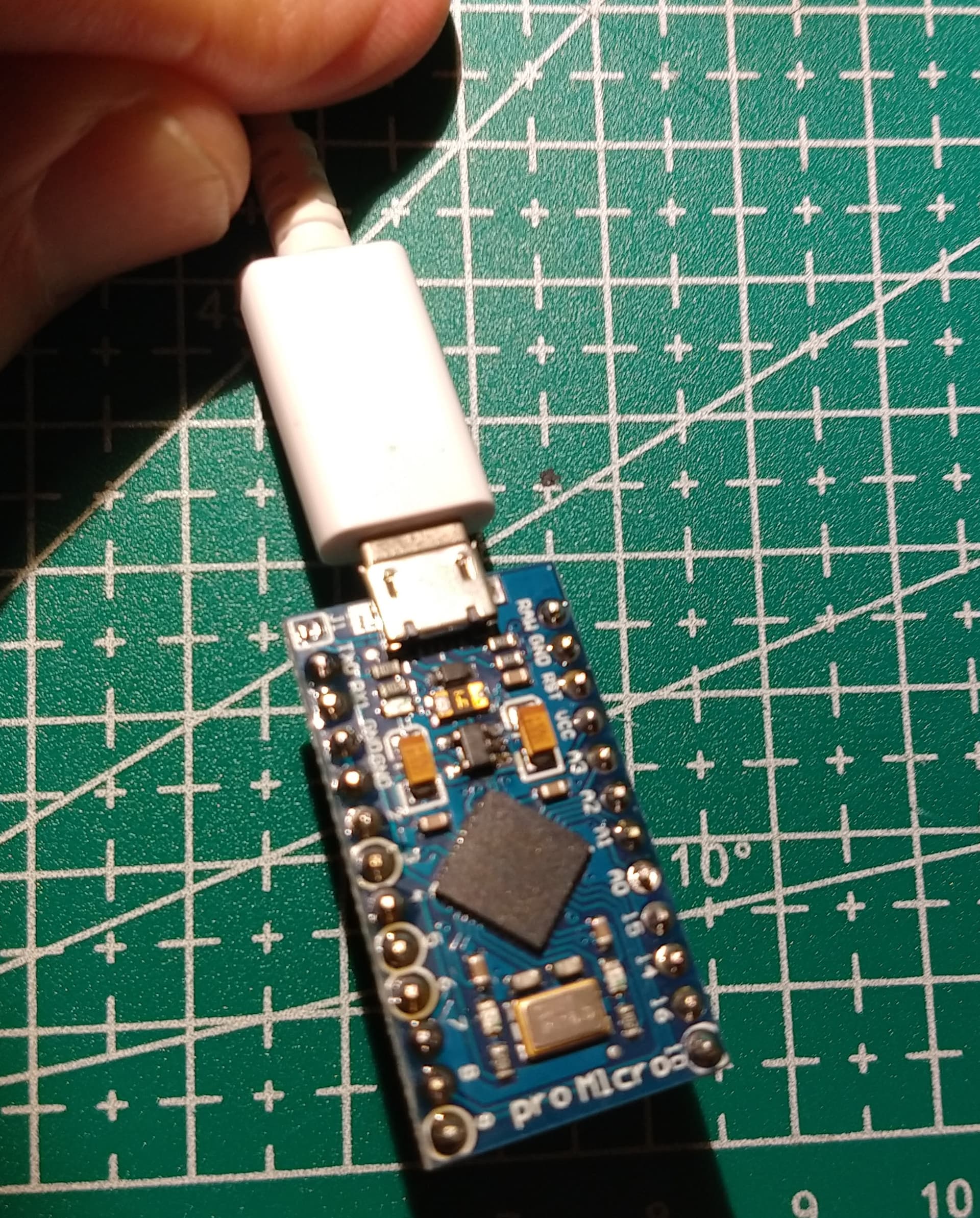

it gets very hot
Can you tell what part on the board gets hot?
  • In the photo below, the blue circle is around the 12V to 5V regulator.
  • The arrow pointing to the component marked "F" I believe is a overcurrent device (PTC)

The part that gets hot is the microcontroller chip.
My regulated CC source gives a stable 12 volts and max 1 amp current. The atmega32U4 gets too hot even if it is powered from the USB with its 5 volts. Before my try with the 12 volts power source it used to not happen.
I made a similar circuit with an Arduino nano but it lacks the USB direct connection support and that is why i tried to do the same circuit with the one you put the picture.
When i connected both power sources, USB and 12 volts, I did like this: USB from the PC cable and 12 volts from the source into the opamps positive and negative pins.
In that occasion the Arduino Pro micro module got sick but it appears to be alive lighting two leds but indicates nothing when i type dmesg command at the console. So, apparently it is dead. Some kind of hot zombie.
The second atemp was the smoky one and when i plug the module to my laptop USB it does nothing and dmesg trows nothing related to the connection...
I forgot to mention that the voltage regulator appears to be dead. It receives 4.68 volts form the diode and gives 0.2 volts at the output pin. I soldered the j1 gap and connected the module to one mobile charger and the power led lits but the atmega chip gets very hot!

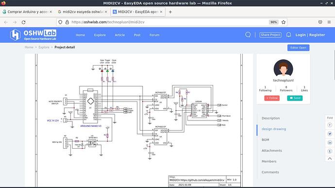

As I mentioned in my JohnRob reply I wanted to reproduce a circuit i made previously with an Arduino nano. I didnt draw my own schematics but i "adapted" this circuit that i have found on OSHWLAB's site ( https://oshwlab.com/technoplusnl/midi2cv )
I think i can reproduce it here since it claims to be a Open Source Hardware Lab.
I substituted Arduino nano with Arduino Pro micro or a Arduino Leonardo's clone, the DAC chips were MCP4725 and the opamp a LM385.
The time i burnt the second one I conected the 12 volts to the raw pin of the Arduino and the opamps power pins. The MCP4725 was powered by the Arduino's VCC pin and all connected to ground.
Now i am thinking that i forget some ground connection o that i missed one pin... I only have one more Arduino to use and that is why i am asking for help, I don't want to waste my last bullet...
