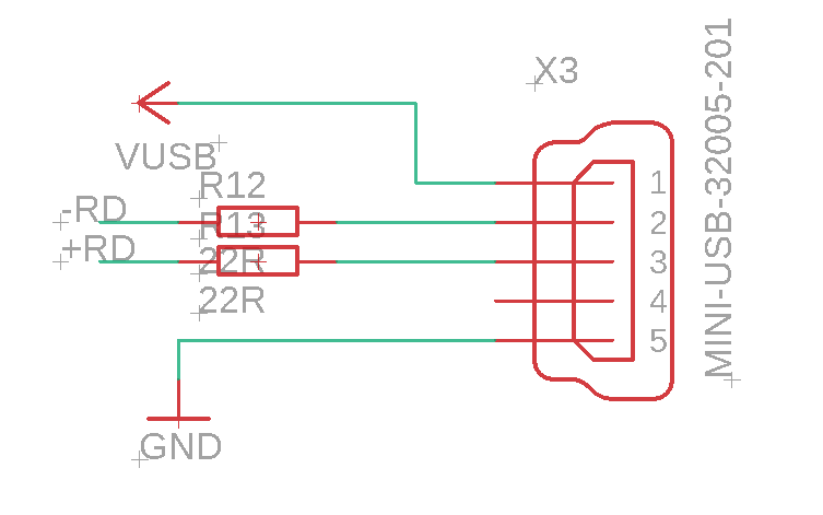

Arduino Micro (stand alone) 3.3v powered
I ve desinged my own arduno micro based PCB which wirks perfectly when USB (or otherwise 5V) powered. However, when supplied with 3.3V the MPU wont run eventhough the oscillator is still working.

Your schematic is incomplete and crucial parts of the power supply are missing.

I guess the only part missing is the USB input shown below.
There will be a SMPS later but i havent built that yet trying to get everything working so far.

Can we have a look at the complete schematic?
(Btw, there's some odd things in your schematic that I can't quite explain, but that look fairly harmless, such as C1 + C2 (why not 1x220nF or just a single 100nF which would be adequate), R7 and R8 which serve no clear function. But like I said, that doesn't explain this problem.)
C1 and C2 are decoupling capacitors each connected near each of the VCC pins of the MPU. Its not the same as having a single 200nF cap.

Here's the complete schematic. Only thing is that regulator IC3 is shown the wrong way round but it has been corrected.
Most other parts of the schematic have been tested and work.
My apologies, the way it was drawn I mistook them for part of an RC filter to bring up RST slowly to prevent problems during startup.
