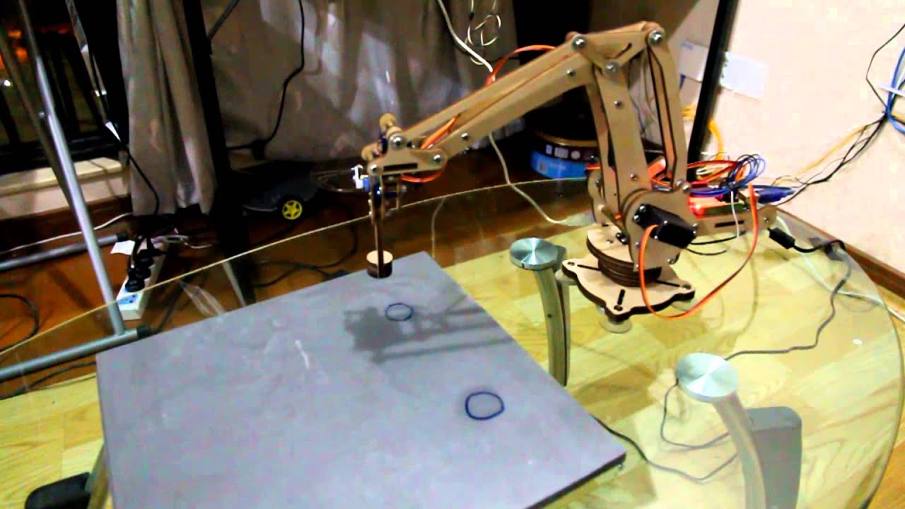

The second version of the robot arm is quite stable now. Here is a stacking test by using the gripper. More applications and test videos will be updated soon.
See the video here:
A Vacuum Gripper Suction Cup is often used on industry robot arm in manufacture. And we also add a small one on uArm.
The Vacuum Gripper Suction Cup is controlled by a small Vacuum Pump and a Solenoid Valve.
We made the first load test of the robot arm by using the Vacuum Gripper Suction Cup. It can lift a 330ml Coca Cola and move it to another place. More applications and test videos with the Vacuum Gripper Suction Cup will be updated soon.
See the video here:
After several tests of the arm with vacuum gripper suction cup, the robot arm can work very well.

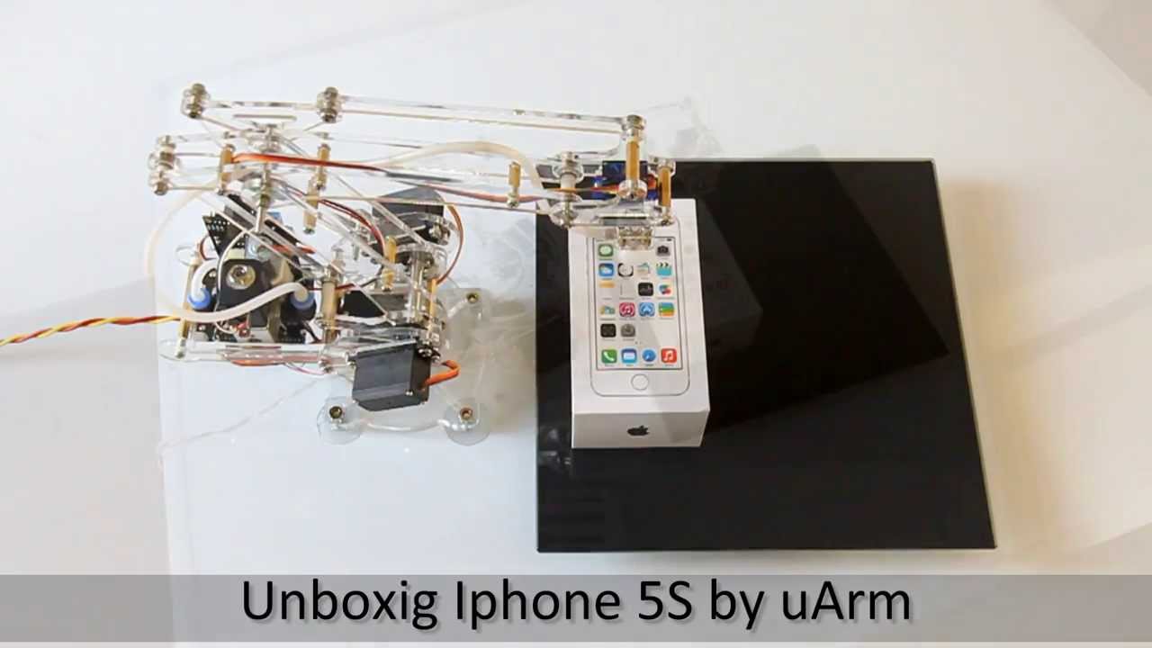

Recently, we got an Iphone 5S, so we decide to make an unboxing test of Iphnoe 5S by uArm.
Let’s see how it works.
More interesting applications and test video of uArm will be updated soon.
