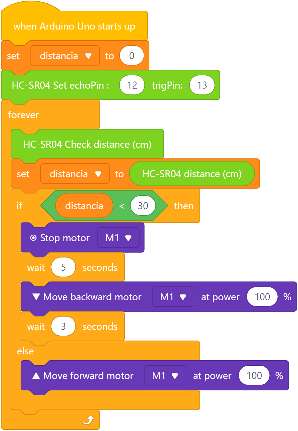

I am using mBlock to generate an Arduino project. It consists in using Motor shield L293D and HC-SR04 Ultrasonic Sensor PCM libraries for an Arduino UNO car of 4 motors.
The problem states:
Move the Arduino car forward and when faced with an obstacle less than 30 cm away, stop for 5 seconds and go back.
The generated Arduino code is:

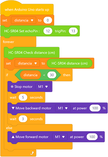

My question is: Is the _delay(3) necessary for the purpose of the exercise?
I think we want to move backward as long as we are near the object (< 30 cm); then go forward to, again, enter the proximity. So the delay of 3 seconds is not necessary.
Is that correct?
Thank you!
P.S. This is the block based solution:
inertia. spinning motor generate electricity, it must dissipate before will apply opposite voltage. remove delay and watch the change.

I forgot to mention it at the beginning, I can't access the Arduino car these days, so I'm programming blind. I wanted to record a video tutorial explaining the programming to have the class ready, and that delay makes me hesitate whether to include it or not. That's why I'm asking for help, because at the moment I don't have a way to test it working.
Thank you for pointing it out. For sure it is not optimized (it is generated by mBlock), but we are focusing on another aspect.
As stated before, at the moment I am unable to test. If we have to dissipate the motor (for each one of four motors), do we need to add a 'Stop motor' with a delay after the backward movement? Sorry, I am not specialized in electronics.

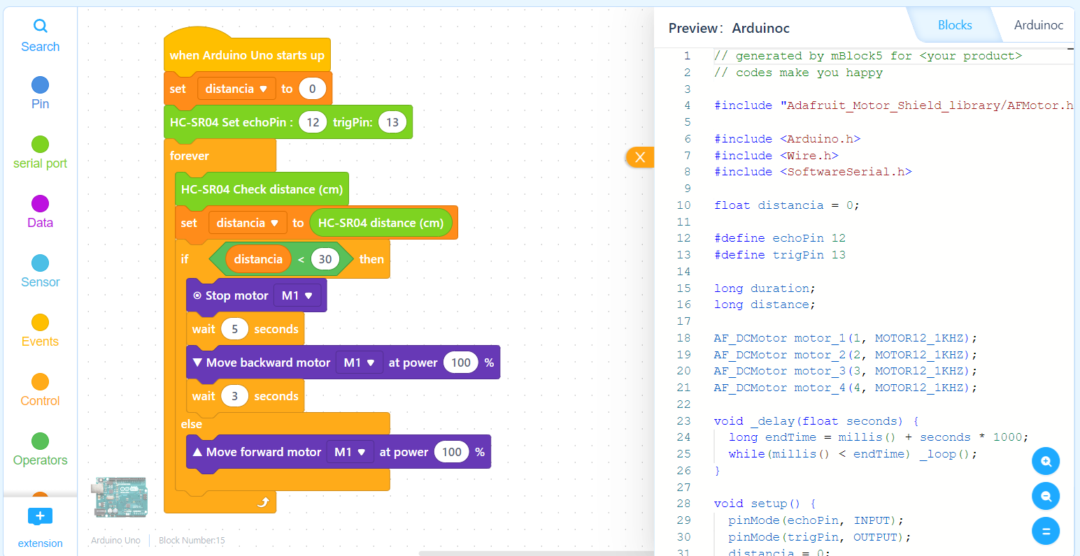

From https://ide.mblock.cc/ you start a new project, program with blocks and then you can preview the generated Arduino code from it:

In general when reversing motor direction, the code should first brake or coast, and wait for the motor to stop completely, before starting out in the reverse direction. Otherwise the motor driver can be overloaded and damaged.

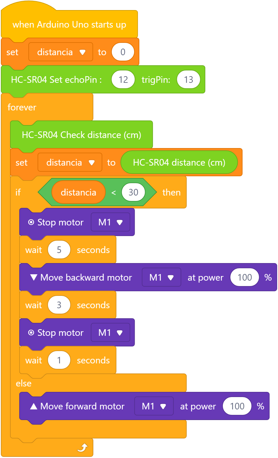

I understand! Is this a good solution?:
Or it would be better to wait 1 second on the else clause?
Please post the resulting Arduino code. The block diagram is not very informative.
Ok. I thought for the scope of the question the block-based solution would be enough, but here it goes:

Idea:
Define 'distance' variable and set to 0. Define the pins where the ultrasonic sensor is connected to Arduino.
Loop over obtaining the distance from the object, and:
  • If the distance is less than 30 cm, stop 5 seconds, move away from the object by moving backward for 3 seconds and stop 1 second to avoid damaging.
  • If the distance is 30 cm or above, keep moving forward.
Is the logic correct? Or can it be improved?

Any means of ensuring that motor rotation is zero, before the direction of rotation is changed, will avoid creating above mentioned problem for the motor driver.

No I think not. It will only delay the detection of the new distance measurement and you don't want to do that.
On the face of it, then it looks acquitted, and the delays you have put into it are needed.
