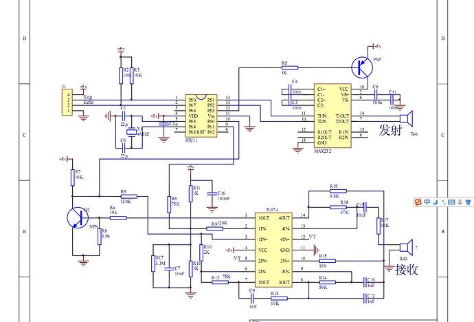

I don't think you'll get enough volume for your purpose just using an Arduino to drive the transducer. The HC-SR04 uses a MAX232 chip to boost the voltage level, and I suspect that even that volume might not be enough. It's got to be loud enough to annoy, not just to hear.
Still, for testing that's not a hard thing to set up. You might need to send short bursts close together though, for the MAX232 to work properly. This is the schematic:-
Ultrasonic transducers are typically rated for a fairly high voltage, about 50Vp-p or more, from memory. Rather then the MAX232 method, a H-bridge with a decent supply voltage might be needed to drive the transducer at a good volume level, with the Arduino driving the H-bridge at 40kHz.
