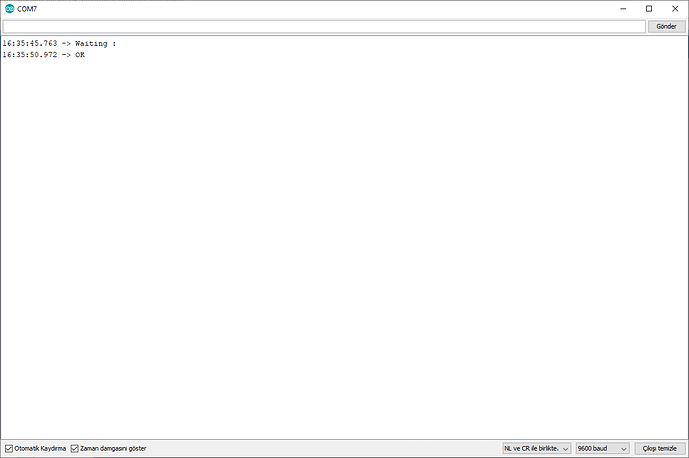

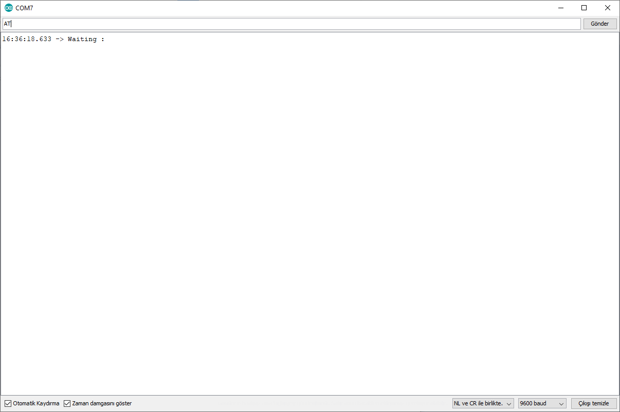

after uploading the code, do not shutdown arduino, HC-05 has it's own CPU so it is working seperately, just disconnect the HTC-05's VCC cable, there is a tiny button on the upper left side of the module, press and hold the button, re-connect the HC-05's VCC cable while you holding tiny button on it.
Led will start to long blinks with 2 second breaks, open terminal through arduino ide (ctrl+shift+m), your terminal settings should be "NL&CR -- 9600 baud", wait until you see "Waiting : " line, then send AT command, device will reply as OK,then you can program as you want.

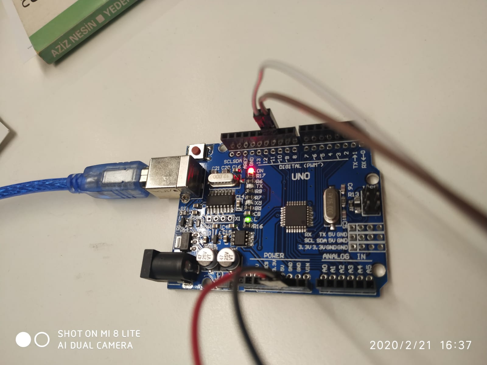

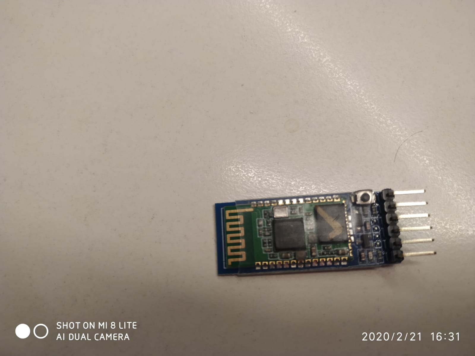

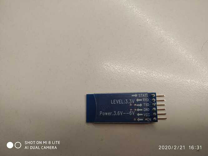

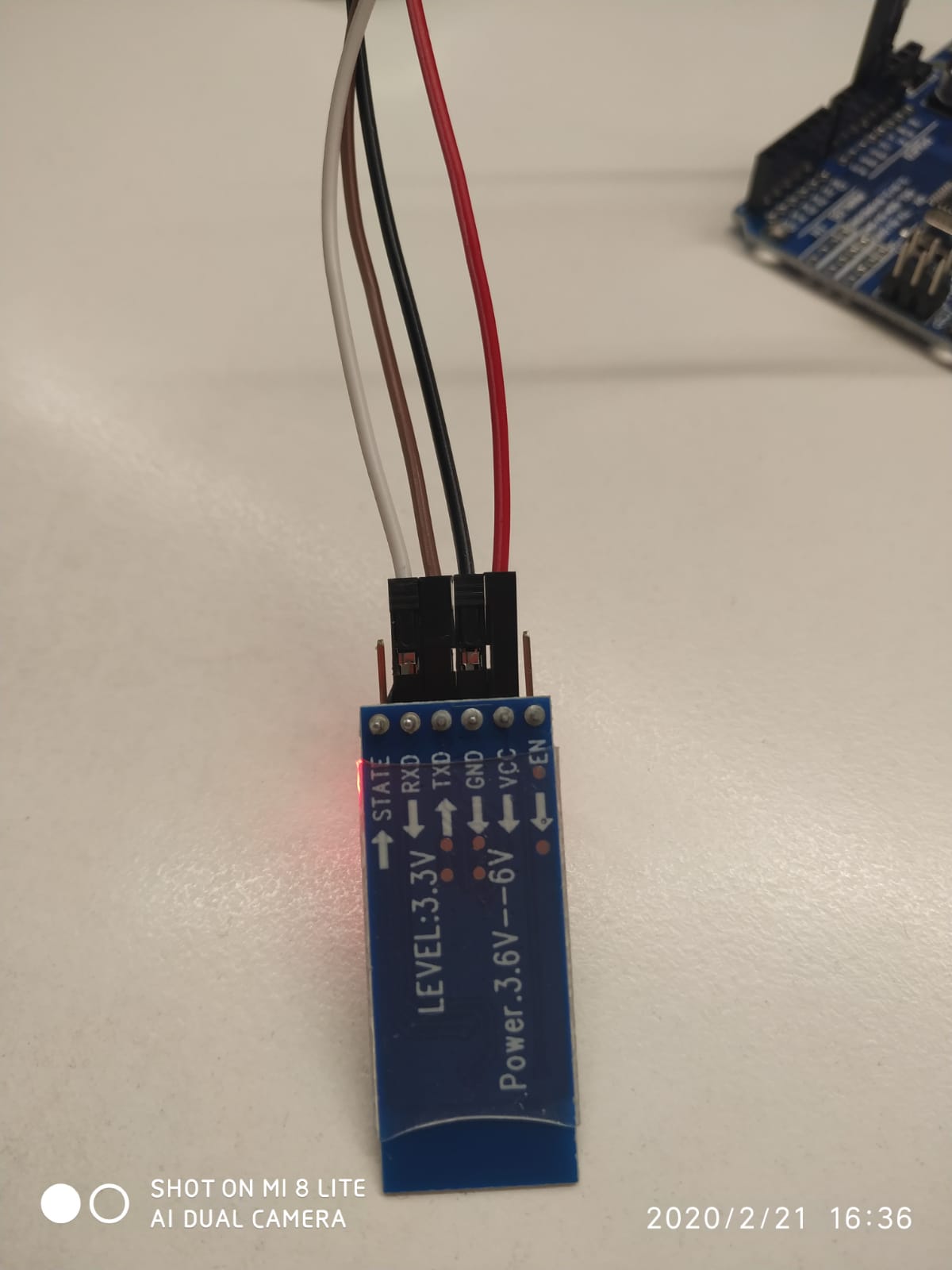

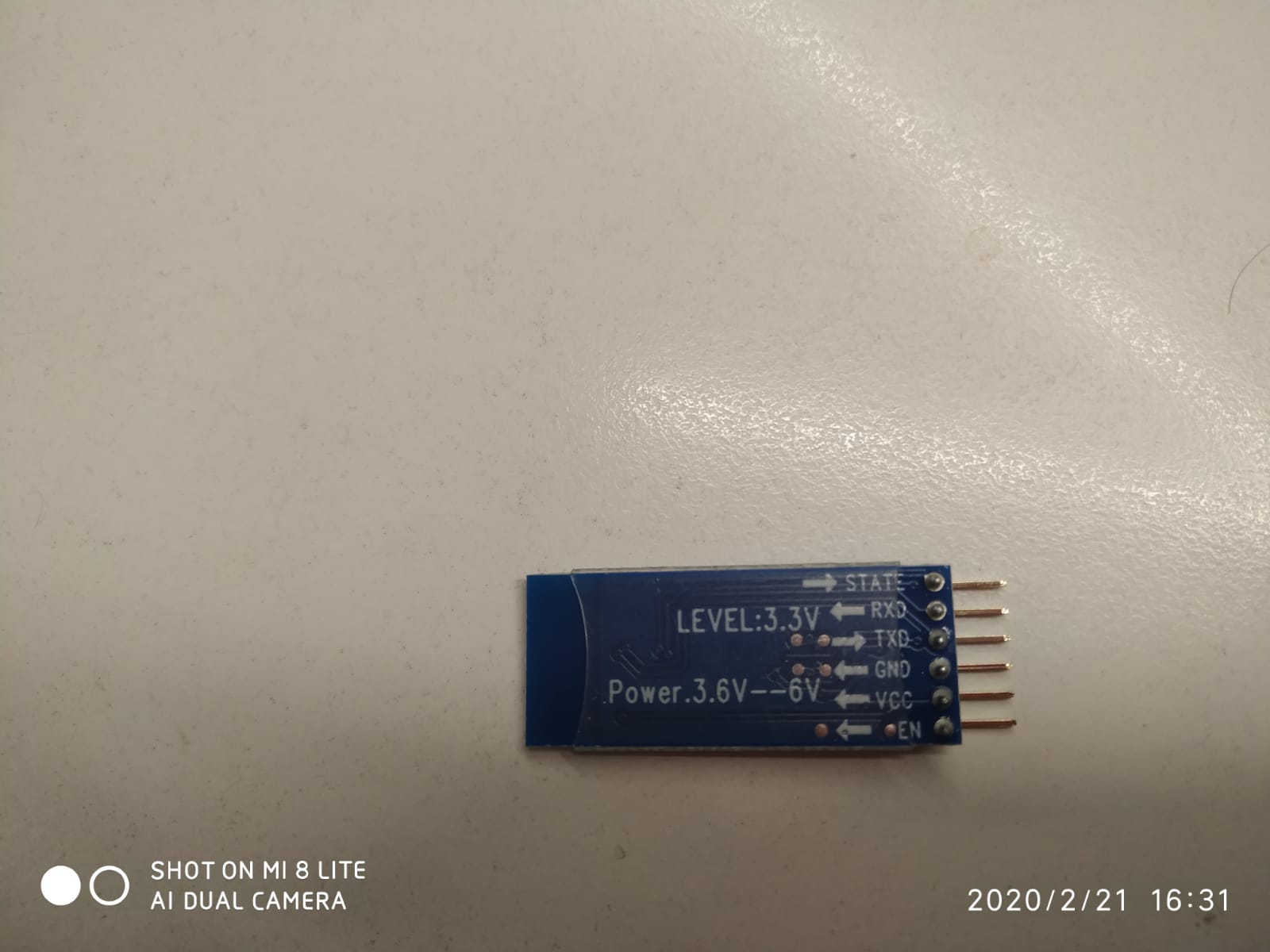

Correction : there are two different modules of HC-05 one has KEY pin other has EN pin, let me check my toolbox if i have one i'll share pictures for connections.
sheshman:

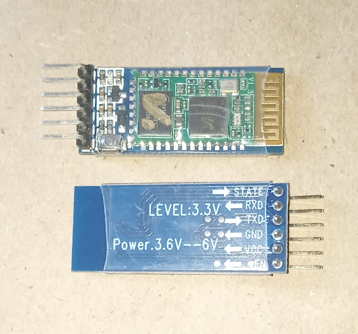

Please compare with this one that i got.

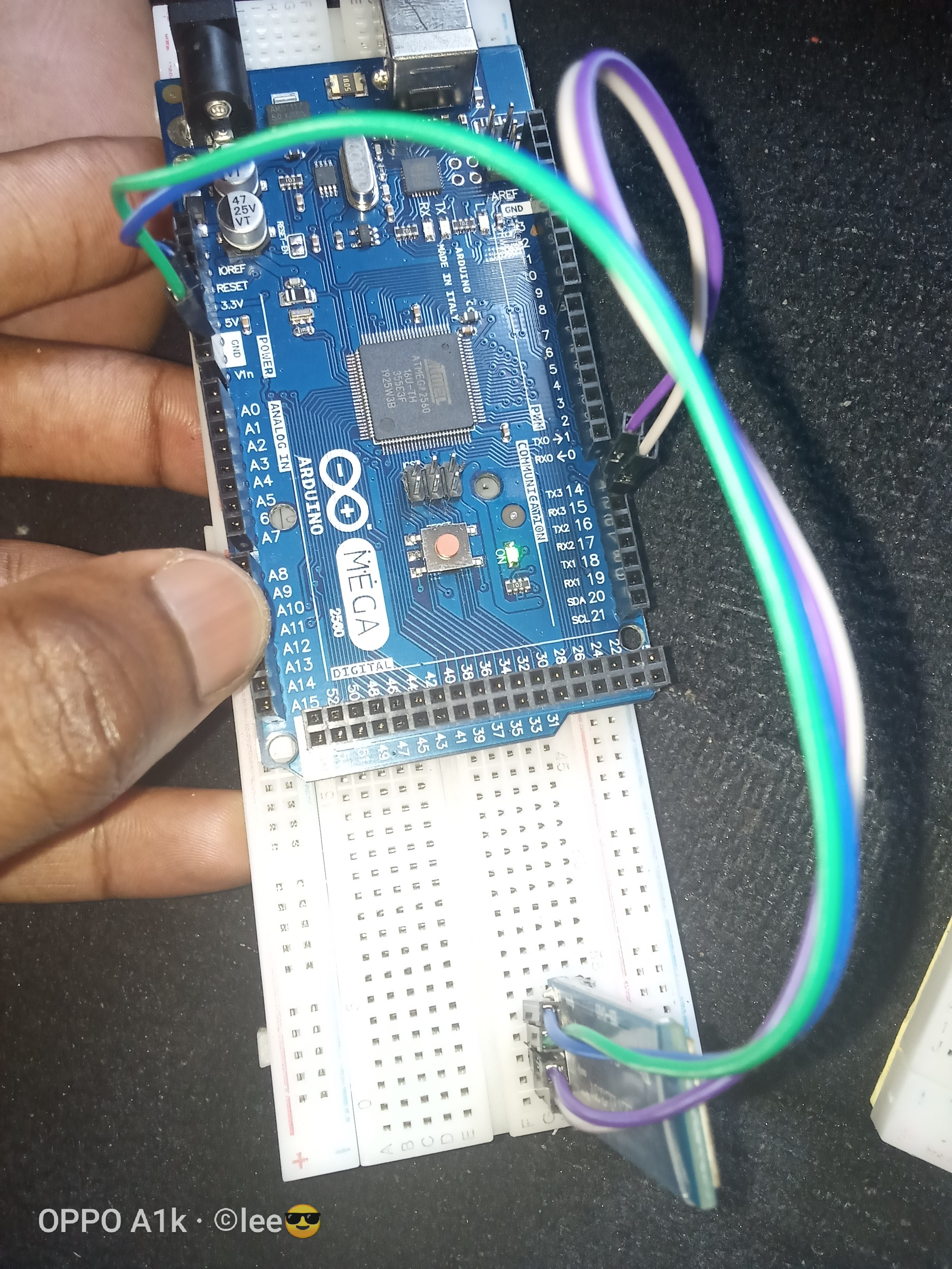

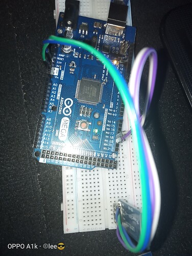

please do not change anything about my example, just try with defaults, you are using 14-15 which are RX-TX pins,it won't work with those pins, older models of HC-05 were working on RX-TX pins but new ones uses digital pins.
PS: you don't need to quote everytime you reply ![]()

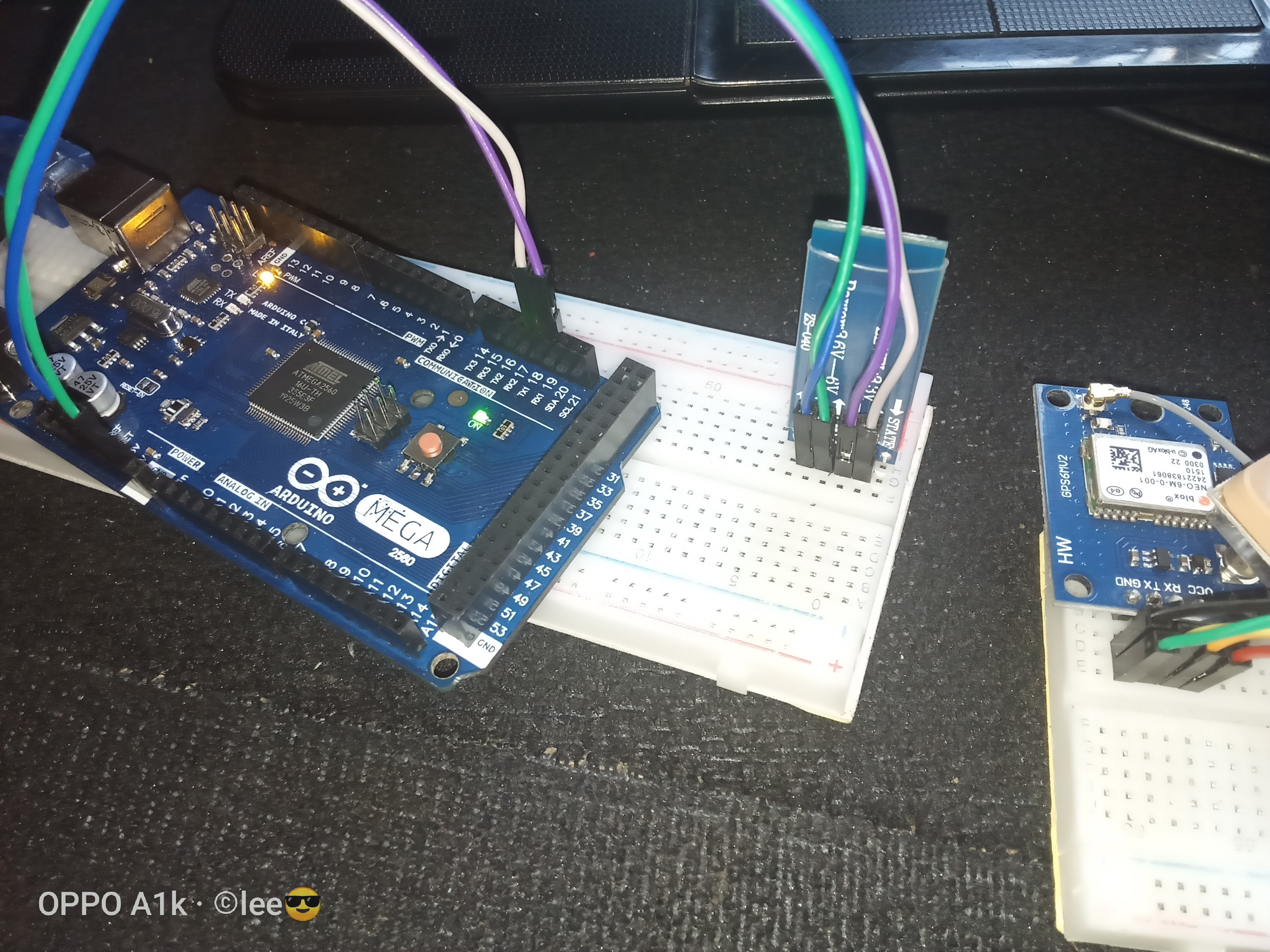

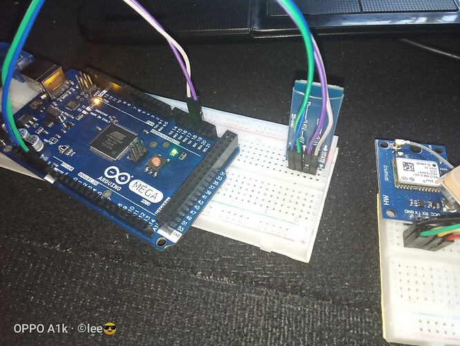

arduino MEGA is expanded version of UNO, for peoples who needs extra pins, 1,0,14,15,16,17,18,19 are for serial port communication, you can not use those pins for digital communication.
Please take a look at this :
sheshman:
please do not change anything about my example, just try with defaults, you are using 14-15 which are RX-TX pins,it won't work with those pins, older models of HC-05 were working on RX-TX pins but new ones uses digital pins.PS: you don't need to quote everytime you reply
I dont understand that...
alexmunala:
you connected RX-TX to 14-15 on your arduino MEGA, on arduino MEGA "1,0,14,15,16,17,18,19" pins for serial communication only,if you connect your RX-TX to 14-15 as you did, then module will not communicate with your arduino, just connect your module to 10-11 as i said and it will work.

I have done the procedure to power on the module, that is, press and hold the button on the module, removed the VCC and returned it, released the button, and the light blinks once in two seconds.
I have uploaded the code but still no reply 'OK' when I enter AT mode.

share your connection

@OP, you might also note that it is good practice to add a 1k/2k voltage divider in Arduino Tx line.
You should not have to go through that connection circus, simply hold the button down as you connect power to Bluetooth.
IF you are using a Mega as your code suggests, it is quite OK to use Serial1 for Bluetooth connection. Just make sure you are connected Tx>Rx and Rx>Tx.
If you are not using a Mega, your code is not appropriate. Check the Martyn Currey website for some sensible guidance.

Yes I have checked again its Rx Arduino - Tx Bt and Tx Arduino-Rx Bt
