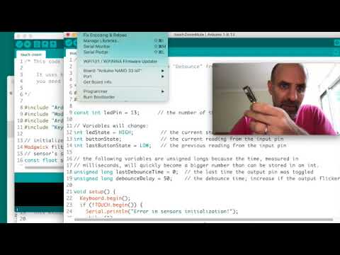

Unable to upload sketch to Board
avrdude: Version 6.3-20190619
     System wide configuration file is "C:\Users\Produ\AppData\Local\Arduino15\packages\arduino\tools\avrdude\6.3.0-arduino17/etc/avrdude.conf"
avrdude: can't open config file "C:\Users\Produ\AppData\Local\Arduino15\packages\arduino\tools\avrdude\6.3.0-arduino17/etc/avrdude.conf": No such file or directory
avrdude: error reading system wide configuration file "C:\Users\Produ\AppData\Local\Arduino15\packages\arduino\tools\avrdude\6.3.0-arduino17/etc/avrdude.conf"
Failed uploading: uploading error: exit status 1

What sort of Nano ?
Normally when people say Nano they mean a Nano classic, but there are at least 6 different types of Nano and counting. It seems that Arduino marketing regard the term Nano as a form factor for a number of very different processors.
So are you using a Nano 33 IoT ?
EDIT @bluejets beat me to it.
Why is that? Are you using a clone and not a real Nano 33 IoT?
yes Nano 33 IoT
Your program conpiles OK but for some reason it can't find the avrdude config file.
Which version of the IDE are you using?
Did you recently install a new board or update the IDE?
If your board is a Nano 33 IoT, the Nano 33 IoT is not prgrammed with avrdude. So I suspect that you selected the wrong board under tools/board. You should have the exact version to select from; if not, you will need to install the board package.
