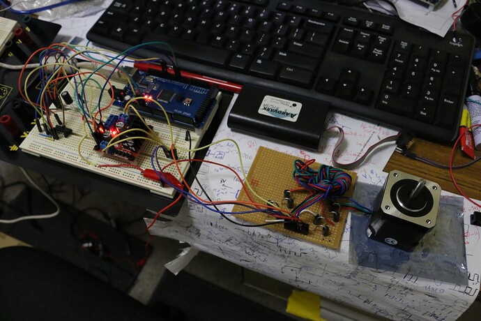

I ended up trying the L298N with NEMA 17 stepper, with the ENA and ENB pins of the L298N driver board each connected to self-configured PWM outputs of the arduino MEGA. The PWM duty cycle was just chosen to be 20% while feeding a voltage of 12V DC into the L298N (to be used to supply the motor). This was just driving the shaft only. The L298N heatsink feels only barely warm for this case. No problem at all. The PWM frequency was just set to 490 Hz, using the advice very kindly provided by:
http://forum.arduino.cc/index.php?topic=72092.0
A picture of my set up is shown below:
I confirm that feeding full 12V DC into the L298N won't work, because the motor coils require some minimum amount of current, which the L298N cannot supply (due to it's maximum power V*I constraint). To get around this, the PWM will reduce the average DC voltage, and at least the coils can get enough current to move the shaft properly.
I'm only driving the NEMA 17 shaft only - no extra load on it. And just using bread-board and vero-board. It's only a test set-up, and always keeping an eye on things like temperature and power dissipations in certain spots.
For all those that want to know if the L298N can drive a bipolar stepper (or even a 5-wire uni-polar stepper converted to a 4-wire bipolar stepper). The answer is yes - you can. Although, using other drivers like A4988 will improve things, like efficiency and size of driver circuit (more compact).
I used the same diode protection board as for YM2754 stepper (5-wire uni-polar used as 4-wire bipolar): 5-wire Unipolar Stepper, L298N H Bridge - #16 by Southpark - Motors, Mechanics, Power and CNC - Arduino Forum
I didn't use PWM on the ENA and ENB pins of the L298N for YM2754 motor. For that case, the ENA and ENB pins were 100% enabled using the L298N board factory-provided jumper pins.

For those that have a L298N board on hand, then a L298N can be used to drive relatively small stepper motors - just depends on requirements of the motor. The L298N has been driving my NEMA 17 really well. I just needed to have a low enough motor supply voltage to get the coil current to be high enough to drive the motor properly, and yet not overheat the L298N chip at the same time. But not too low a supply voltage where the L298N electronics can't function.
