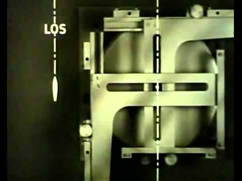

i would like to be able to control the speed and direction of a motor with a pot
the method would be to use the first half of pot rotation to run the motor in one direction and control its speed and in the in the second half of pot rotation run the motor in the other direction and control its speed
in the middle of the pots rotation the motor would be stopped and increase in speed in either direction of pot rotation
the mechanical analogue would be a disk driving a wheel that traveled from one side of the diameter to the other, increasing in speed as the wheel traveled from middle to edge and stopping as the wheel was in the middle of the disk
i would like to be able to set variables for min and max speed of the wheel and set the the zone on the pot of no speed

i'd like the motor to respond as though it were the mechanical system i described
What about what I described doesn't do that?

here is a link to what i'm trying to copy, it starts at 30:45 to 35:30
https://www.youtube.com/watch?v=bOwKh9XLO1c

I'm certainly not going to wade through half an hour of youtube....
