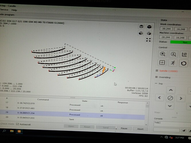

I am using Arduino Uno R3, blink file has been uploaded and also grbl file. I am using Candle Software for the controller.I am using Tb6600 driver and cnc shield for Arduino.When I open the file and run it, it runs in candle control well, but the drivers and motors do not run.There is no response and the RX andTX LED is blinking continuously.Can't understand the problem. Is there any problem in wiring please help...

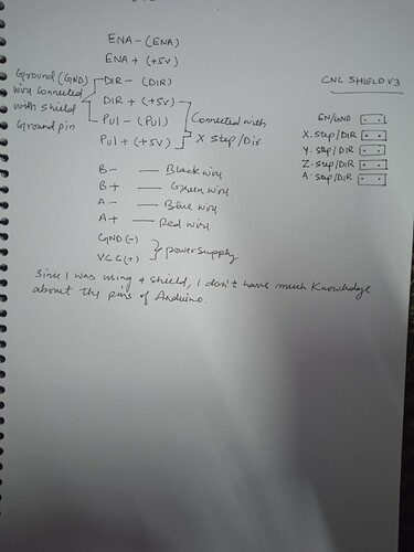

Please post schematics.
Using the TB6600 no CNC is needed.
In Arduino Uno r3 blink or grbl file is uploaded or in Arduino board RX TX leb is blinking continuously. I am still using the candle software and it receiving the gcode but the motors are not running. It was working fine some time ago but now I don't know what problem has happened. Pul- or dir- =GNDpin
Again, please provide schematics.
What would the very last sentence tell? Pul, dir = GND?
Sorry but please tell me schematic means wiring diagram or something.
Yes, wiring diagram, showing pin desinatios, power supply and its basic data.
This is just the wiring I did.
Please look at other topics and see what schematics, wiring diagram, looks like. It's not a list of wire connections.
So can you tell me which topic will be right for me?

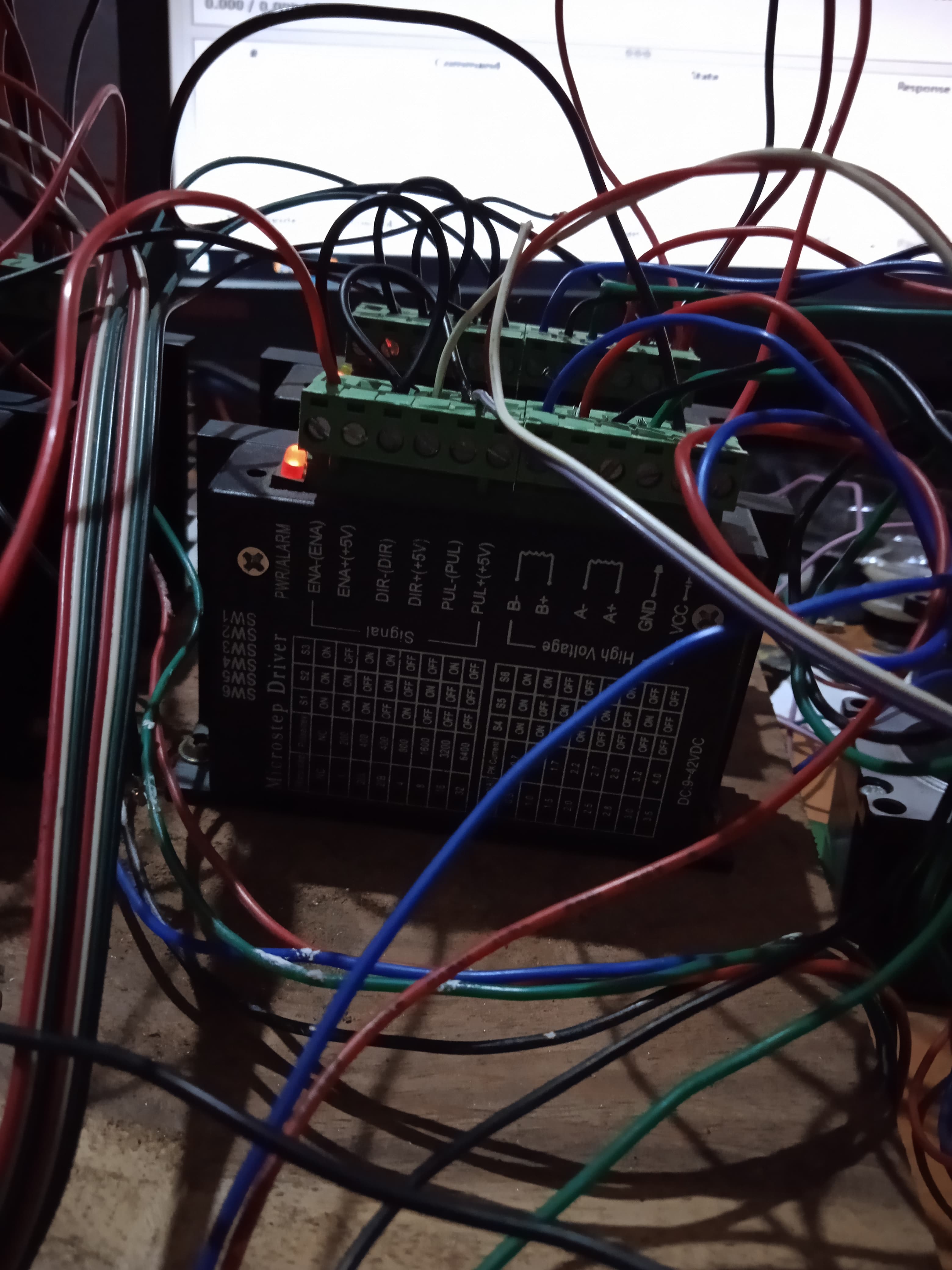

Are you sure that you have the stepper enable on the TB6600 drivers set to the right state to enable the motors?
How do I set right state for enabling the motors.
This is what I don't understand.
I have shown my wiring in the images, can you give me the correct wiring diagram?
I have not experience with TB6600 stepper drivers, but I have seen them used and, I think, most people just leave the EN pins unconnected.

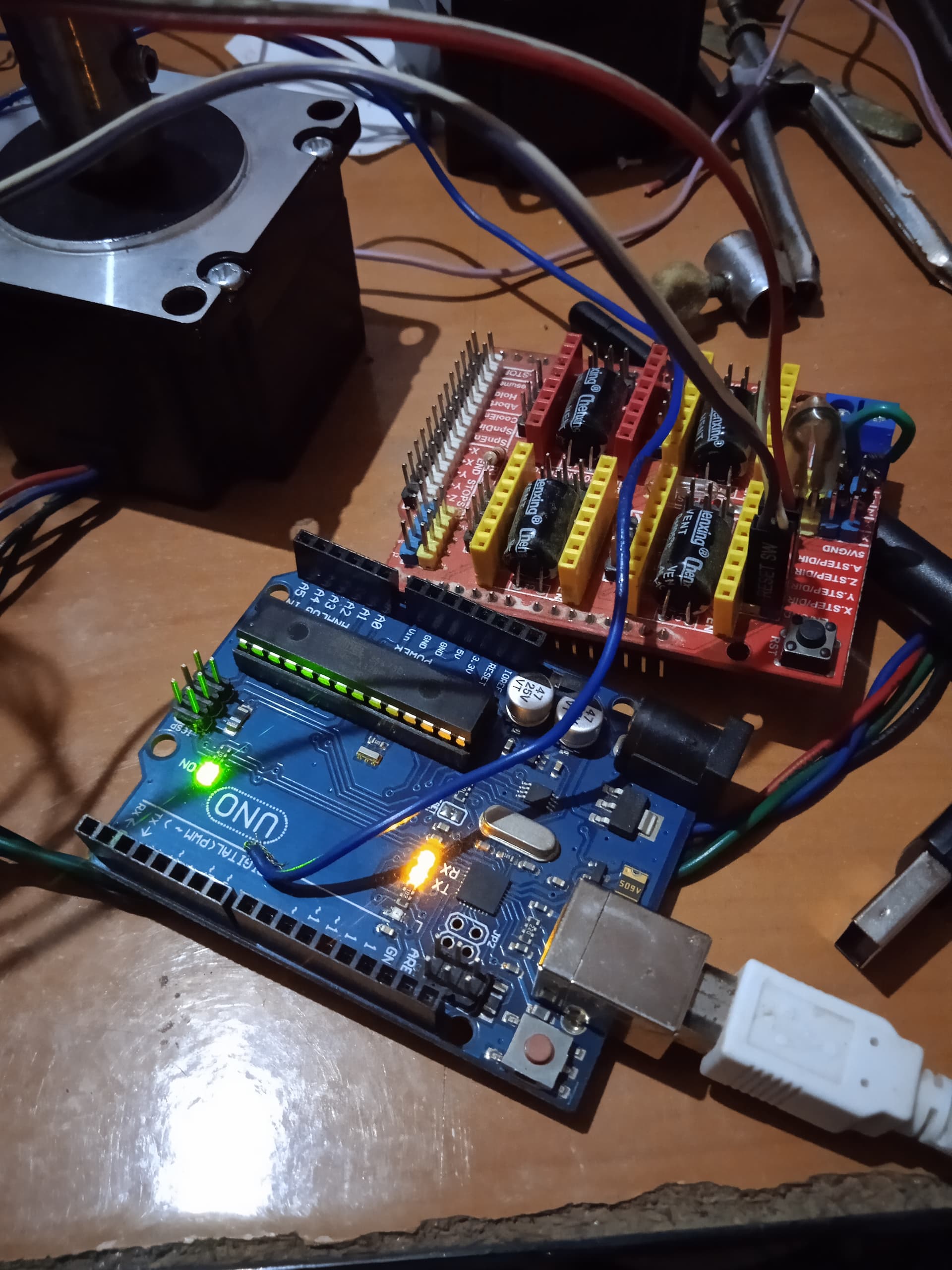

Why are you using the shield? It is not plugged onto the Uno in the photos. It would seem that it would be less complex for you to just connect the TB6600 drivers straight to the Uno.
A TB6600 user guide >> https://www.makerguides.com/wp-content/uploads/2019/10/TB6600-Manual.pdf
At the back it is showing 2 pins for X,Y,Z. Where are the pins for the 3rd driver to be connected?Where will the third driver's pin go?
