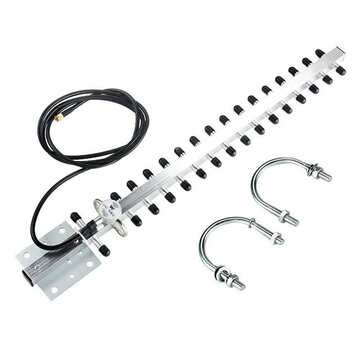

If you had a couple of ESP32's (with the external antenna jack) and set them up with these, you'd probably be good for miles. (The aiming will be critical.)

Sure, but then you exceed the legal transmit power.
Given the audience and the company funding this forum it's best to only suggest solutions that are 100% legal.
Give me a break.
People here do marijuana-growing projects.
Anyway, it's an antenna, not an active amplifier.
Outside your ken obviously.
Any antenna that focuses power increases the ERP in the direction of the beam.
The Effective Radiated Power, not the actual power.
Its the ERP/EIRP that gets you in trouble.
For example, From Australia
"In Australia, we use the 915-928 MHz frequency range with a maximum Equivelant Radiated Isotropic Power (EIRP) of 1 watt. In general, if you use AU915 compliant LoRaWAN modules, you will be complying with the standard."
1mW, 1dBm, * 25db ("gain") is a bit more than 300mW.
