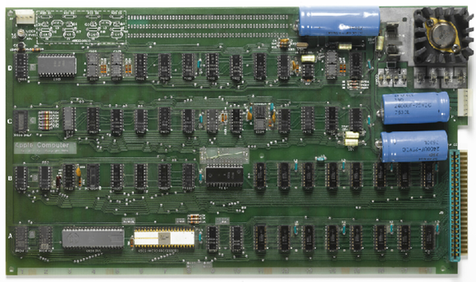

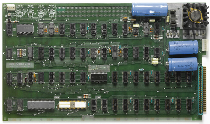

The two years will be great, at US develop board like Yun might only has 90 days warranty.
The Apple-1 computer operation manual and warranty – 1976
Apple-1 computer has a period of thirty (30) days from date of purchase warranty.
A functioning Apple 1 computer, one of the first 200 computers sold by Steve Jobs and Steve Wozniak, sold for $374500. without warranty, which is not 30 days passed but 36 years passed.
