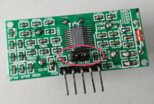

Most people using cheap ultrasonic distance measuring devices seem to opt for the cheapest of the lot - the HC-SR04. Largely this is probably a bad idea - as the US-100 costs little more (it is almost twice the price but absolute costs are low, at £2.32 for a US-100) but is superior in terms of accuracy and precision.
See the review on the blog below if you want details on that. Basically, the difference is that the US-100 sends the measured distance over a serial connection rather than requiring the connected Arduino to measure the duration of a toggled pin (a method that does nothing for accuracy or precision).

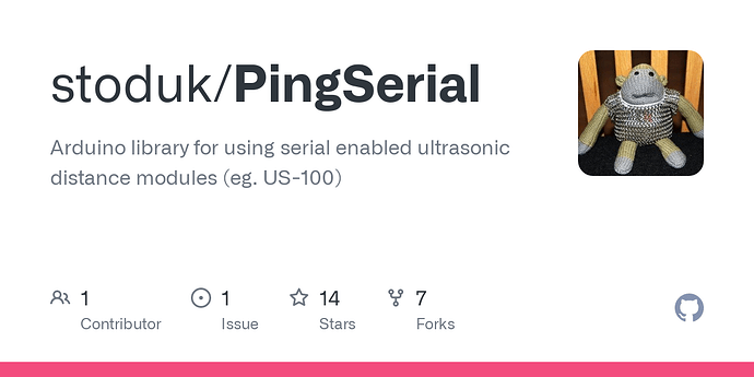

I needed to use a US-100 and there seemed to be no pre-existing libraries for this, so I wrote one. Links below, all the details are on GitHub.
Enjoy!
http://playground.arduino.cc/Code/PingSerial

Did you see my comments on the second article? They give an idea of my experience to back up my assertions, more detail below. Here are the reasons for the inaccuracies:
  1. Inaccuracy in measuring the echo timings
    I'll assume most people aren't using pulseIn() (it is blocking, and has accuracy issues of its own) - but instead NewPing's timer base polling or similar. This has a default polling period of 24us, so in the worst case we are adding 4mm to any measurement (24/1000 * 344).
This is a variable error as we might just poll at the point the echo pin is triggered, or we might not poll until the full 24us after the echo pin changed state. This impacts precision, rather than accuracy, as in the ideal best case we could still perfectly measure the distance. Realistically we'll have a 2mm±2mm variation on measurements.
So a simple lack of precision here, and one you could potentially avoid by using pin-change interrupts but only if you can guarantee your microcontroller cannot be delayed in handling that interrupt (ie. no other interrupts can block it).
  1. Temperature variation
    Speed of sound (m/s) = 331.4 + 0.6 Tc; Tc is temperature in Celcius, and this is an approximation valid only around room temperature.
So this is a lack of accuracy, as the offset will be static at a given temperature.
US-100 avoids both of these issues. It has temperature compensation natively when used in serial mode. It avoids the need for precise measuring of the timing of pin state changed by sending the measured distance to a UART on the microcontroller. Result: improved accuracy and precision.
