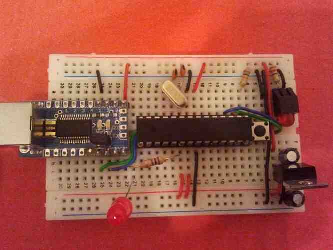

Hey there,
I’m trying to rebuild an Arduino Uno with basic components to get an better understanding of it. I followed the instructions to build an basic Arduino Standalone, which basically works fine for me. But somehow I can’t manage to set up a working USB 2 Serial Connection. Power supply works, but I can’t upload new sketches on my ATmega (I tested ‘Blink’). The Adapter is recognized by my Win7 system and I set Com9 as my serial port. The IDE compiles my sketch, but then tells me it has problems uploading the sketch to the board:
Binary sketch size: 1018 bytes (of a 32256 byte maximum)
avrdude: stk500_getsync(): not in sync: resp=0x00
avrdude: stk500_disable(): protocol error, expect=0x14, resp=0x51
I got a Mini USB Adapter (Pinout: see http://arduino.cc/en/Main/MiniUSB) and connect it the following way:
TX Adapter - RXD ATmega (green)
RX Adapter - TXD ATmega (blue)
5V Adapter - Power supply (red)
GND Adapter - GND (black)
What do I have to change to make this work? I attached an image.
Hope you can help me figure it out! Thanks in advance :slight_smile:

Hard to say about the wiring, the picture is very grainy. Can't even tell if the reset pin is connected to the switch. If you measure the voltage on the reset pin, is it at 5v and going to 0 when the switch is pressed?
Yes it is very hard to see and determine if you have the reset pin’s resistor and reset switch wired properly in that picture, my best guess is you might not.
However, reset wired correctly or not, you are always going to be fighting the lack of a auto-reset feature on your layout. The arduino IDE relies on the ablity to automatically reset the board at the correct time to upload a sketch to your layout. Hitting the reset button to accomplish this is not just a matter of hitting the reset button, but rather hitting and releasing it at the correct instance required. If your USB converter module is of the newest ‘revised’ version, they make the DTR signal avalible on one of the pins and if you just connect a .1ufd cap between that DTR signal and your chips reset pin, you will have the same auto-reset feature that all the current arduino boards have.

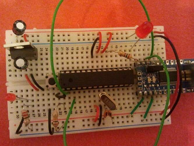

I took a picture of the new circuit, perhaps you can see the connections better now.
Sorry by the way for the grainy picture quality! I just have my mobile phone camera.
The reset switch is connected right in the first picture, it’s just hidden.

So if you measure the voltage on the reset pin, is it changing with your switch? I ask because switches like this usually have pins 1/2 and 3/4 connected internally - so you may have pin 1 wired to ground and pin 2 to the reset pin, so the switch is not doing anything.
I tried the auto-reset feature - no luck. Neither with a 1uFD cap, nor with a .1uFD cap (which I built by connecting 10 1uFD in a series).
@CrossRoads: the reset pin works, it restarts my sketch each time I press it (easy to see, as my current sketch lets RGB-LEDs blink in a certain pattern and has an unique beginnig sequence which reoccurs everytime I reset the ATmega).

I finally got it to work!! :D
For anyone with the same issue: I had to switch the wiring.
Initially (not working): TX Adapter - RXD ATmega RX Adapter - TXD ATmega
Now (working): RX Adapter - RXD ATmega TX Adapter - TXD ATmega
It doesn't make sense to me, but it works! I guess the wiring below always needs to be used with the blue USB Mini Adapter (which is featured in no tutorial), whereas the wiring listed above needs to be used with the red breakout chip. Thanks everyone for their help!!
