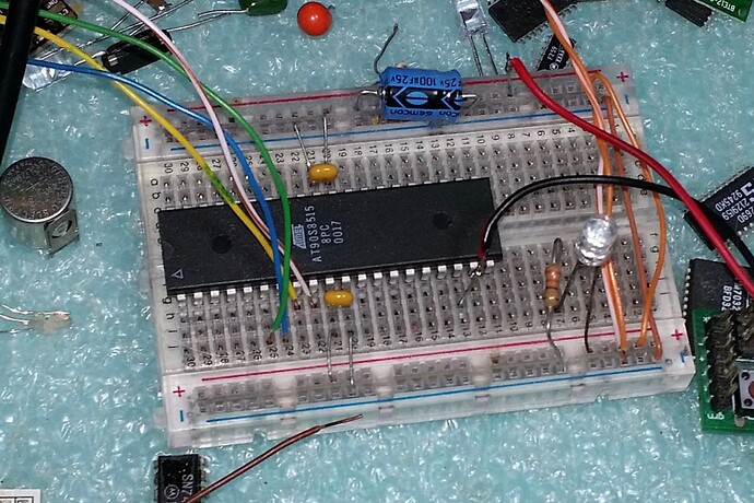

Here's a photo of the setup/wiring I use for programming ATmega32 chips (for internal 8MHz clock.)
Note the power wiring to both sets of power pins, and extensive power bypassing...
(Pay no attention to the fact that the chip in there now is not an ATmega32!)
