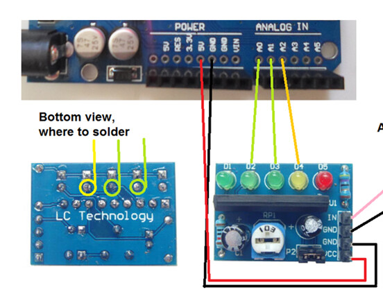

Using a KA2284 LED sound meter module to drive a servo
Hi every body:
I asked questions on this sketch before, and got some great help. I have continued developing my project, and now have a new problem. This project is basically a skeleton that (when an IR Remote is pressed) turns his head, says an MP3 file, and turns his head back. The attached sketch works almost all of the time. Once in a while, the MP3 player just plays a second of the MP3, but if I reload the sketch, it works fine again. The phase I am working on now is to have the skeleton’s jaw move in sync to the MP3. I am using some of Mike North’s Jawduino method. He uses a KA2284 LED sound meter module, with three of the LEDs connected to three analog pins in the Arduino. This is a relatively common method to do this.
My current sketch does not yet address the KA2284 LED sound meter module. However, when I plug just the ground wire of the KA2284 LED sound meter module into the common ground of the rest of the project, the MP3 then only plays a second of the message. If I disconnect the KA2284 LED sound meter module ground wire, and re-load the sketch, it works fine again.
So it looks like my sketch is OK, but something happens when I touch the KA2284 LED sound meter module ground wire to the project’s common ground. Should I power the KA2284 LED sound meter module with its own isolated power supply? Could the KA2284 LED sound meter module be defective? Do I have an issue with interrupts in the libraires? This is outside my expertise.
I am using a Arduino Uno R3, and a DFRobot DFPlayer Mini. I will attach the sketch in question, which seems to work, but does not yet address the KA2284 LED sound meter module. I wired in the module and started writing the sketch that will use it to move the skeleton’s jaw when it all went downhill.

I don't think the following sketch is of value to this post, but this is a draft of the portion of the sketch to use the KA2284 LED sound meter module:
// to make a servo move in sync with audio.
//This is a bare bones test of the HiLetgo 5pcs KA2284 Level Indicator Module

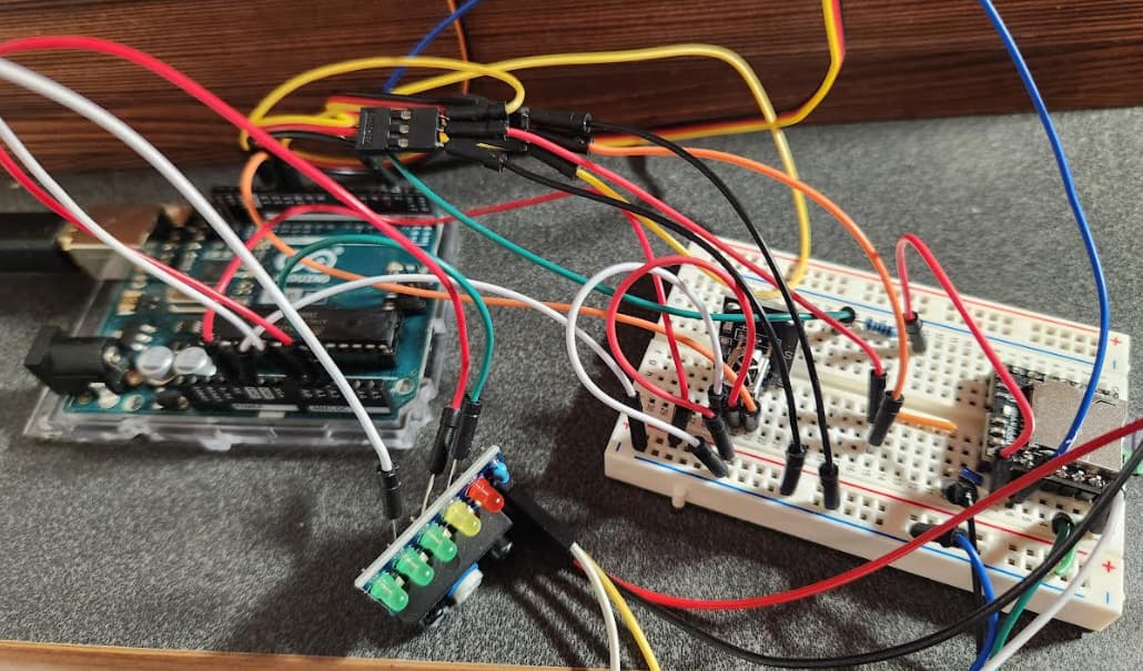

Thanks for your help, I know I sent a lot here, but did not know what you folks would need to help me.
Here's the wiring:
The code needs to be formatted. Use IDE Tools/Auto Format.
The photo of a jumble of wires is not helpful. Normally, a photo of a hand-drawn diagram is ok, but you may have too many wires. Can you reduce the circuit to just the parts needed to resolve your concerns? In other words, if a segment is working OK, then leave it out.
Thank you for helping me. I am very confused as to what‘s happening. The current version of my sketch is the longer (first) code in my post (above). It works perfectly; when button 1 is pressed, the servo turns, and the MP3 plays, and the servo turns back. This happens every time I try it (which is good), until all of a sudden, when button 1 is pressed, the servo turns, and the MP3 only plays for a second. I thought I had this fixed, but as of yesterday, it still fails once in a while. I did notice that when it fails, if I reload the sketch, it works fine again. I have not been able to find out why, so I guess that is my first question.

In my earlier post (above) I mentioned that my current sketch does not yet address the KA2284 LED sound meter module. However, when I plug just the ground wire of the KA2284 LED sound meter module into the common ground of the rest of the project (while running the big code above), the MP3 then only plays a second of the message. If I disconnect the KA2284 LED sound meter module ground wire, and re-load the sketch, it works fine again. I appear to have solved this. I hooked up the KA2284 LED sound meter module to its own power supply, and did not connect its ground to the project’s common ground. The MP3 plays fine now, so I guess that part is solved. I have noticed that the yellow LED on the KA2284 LED sound meter module is always on if the audio input ground wire is attached, so that may be my next problem, unless it is related to my not using a common power ground for the KA2284 LED sound meter module. If anyone has ideas on this as well, I’m all ears.
By the way, the DFRobotDFPlayerMini and the servo are running off another power supply. The IR remote is running off the Arduino power.
I realize the photo of the wiring is a jumble. Here is a conceptual diagram:
So, my remaining question is now why does the MP3 player sometimes stop playing the full MP3, until I reload the sketch? I realize this drifted off a bit from the post’s subject heading (sorry). I hope I gave enough (and not too much) info. Sometimes the real problem is knowing what to ask.
Sorry to add to my post; the servo in my project makes a clicking sound depending on which "squiggly" pin I use for the signal. Are some pins better than others for servos?
The -V from the external power supply is connected to the V+ of the Uno? This is a strange concept indeed, and I don't think it will work at all.
No Arduino pin is suitable for powering the servo. It needs to be powered by an external power supply and connected directly to it, both for +V and ground. This external power supply must have a common ground with the Uno ground. That common ground can go via the breadboard.
Also motors of any kind should generally not be powered through a breadboard. The internal contacts inside a breadboard are not designed for the high current that motors draw. The power and ground should come direct from the external power supply, as mentioned. The control signal for the servo can go via the breadboard. Only a tiny current flows in that wire.
Oh man, i am SO SORRY. NO, the drawing is wrong. The only thing the Arduino is powering is the IR Remote detector. Here is a (hopefully) correct drawing:
As I think I've suggested to you before, please follow standard practice of using red for wires to +V and black for wires to ground.
IMO your confusion is largely down to your poor communication. Your subject is headed 'Using a KA2284 LED sound meter module to drive a servo'. Yet in your opening post you tell us "My current sketch does not yet address the KA2284 LED sound meter module." For which project are you seeking help? By 'project' most of us mean the sketch and accompanying wiring schematic, plus details of all hardware and supplies involved. Accurately presented. And with a concise description of any errors when you compile, upload and run it.
To get this working, start by setting aside "Mike North’s Jawduino method" and at least get the DFR and servo working reliably. Not "...almost all of the time." How can you expect to proceed from an unstable start point?
As for the bizarre "something happens when I touch the KA2284 LED sound meter module ground wire to the project’s common ground", that sounds like loose wiring. If the wire you attach is electrically isolated it should not have any effect.
