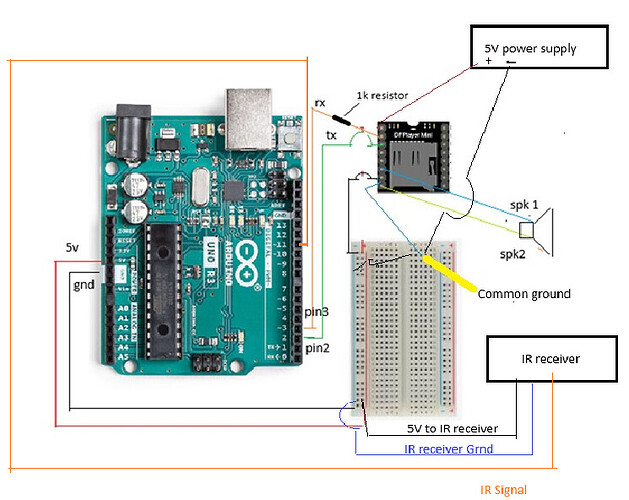

Here is the circuit:

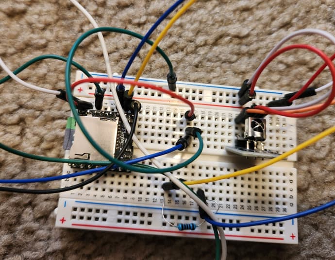

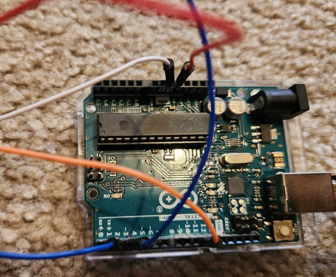

  • Show us good images of your ‘actual’ wiring.
Here are some are photos (sorry about the quality). I checked for loose wires, but didn't find any. Like I said, it worked great and then stopped working.
  • Those wires often become intermittent/open.
  • Replace each wire, one at a time, with a wire you have checked for good continuity.
    You might have multiple bad wires too.
Will do. Thanks.

That resistor is supposed to go between the Arduino TX and the DFplayer RX.

I think I have the resistor between the DF player RX (its pin#2) and the Arduino Tx (Arduino pin #2)? I removed the

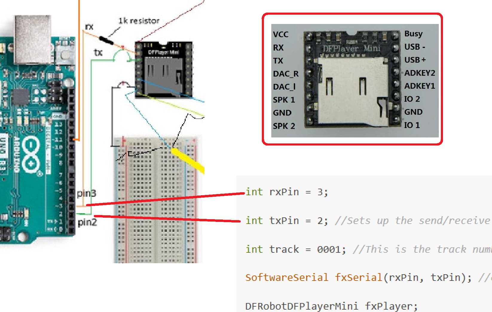

This is all your stuff with the official DFRobot provided pinout in the upper right corner.
How well does it all mesh ?
Pin#1 of the DFRobot (the VCC pin) goes to the positive side of a 4.5 volt power supply.
Pin#2 of the DFRobot (the RX pin) goes through a 1K resistor to pin#2 of the Arduino Uno.
Pin#6 and pin #8 of the DFRobot (the SPK pins) go to a 2 inch speaker(I don't know the wattage) .
Pin#3 of the DFRobot (the TX pin) goes to pin#3 of the Arduino Uno.
Pin#7 of the DFRobot (the GND pin) goes to a common ground with the 4.5 volt power supply and the Arduino and the IR Remote.

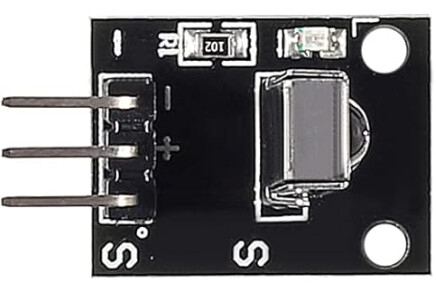

As for the IR remote (which I realized is not in the drawing), it is a HX1838 DWEII-AV_RECEIVER from Amazon (Amazon.com: DWEII 6 Sets Infrared IR Wireless Remote Control Module Kits DIY Kit HX1838 for Arduino Raspberry Pi : Electronics)
The minus pin of the IR remote goes to the common ground.
The plus pin of the IR remote goes to the 5 volt pin on the Arduino Uno
The signal pin of the IR remote goes to pin 11 of the Arduino Uno.
I am obviously new to Arduino programming, but I was wondering if my problems have to do with what the Arduino is doing between button pushes on the IR remote. Should I be using a more robust interrupt situation like While loops, or something similar? I thought the IrReceiver.resume() helped there. As I have said, this setup works (usually once) and then stops working, Thanks again for all your help.
Here is the IR remote:
It seems to me it's not a matter of "newness".
Your documentation does not square well with your recounting.
So far as this IR aspect of things goes - you ought to develop an understanding of how it works with a sketch where the result is a letter printed in Serial Monitor for each button, without involving other hardware.
From there, instead of printing a letter on SerialMonitor you could send a command (via SoftwareSerial) to the DFPlayer - which, in a way, is nearly the same thing.
Haven't seen where (2 topics) you've successfully gotten the DFPlayer to work, simply enough, with the SoftwareSerial implementation.
